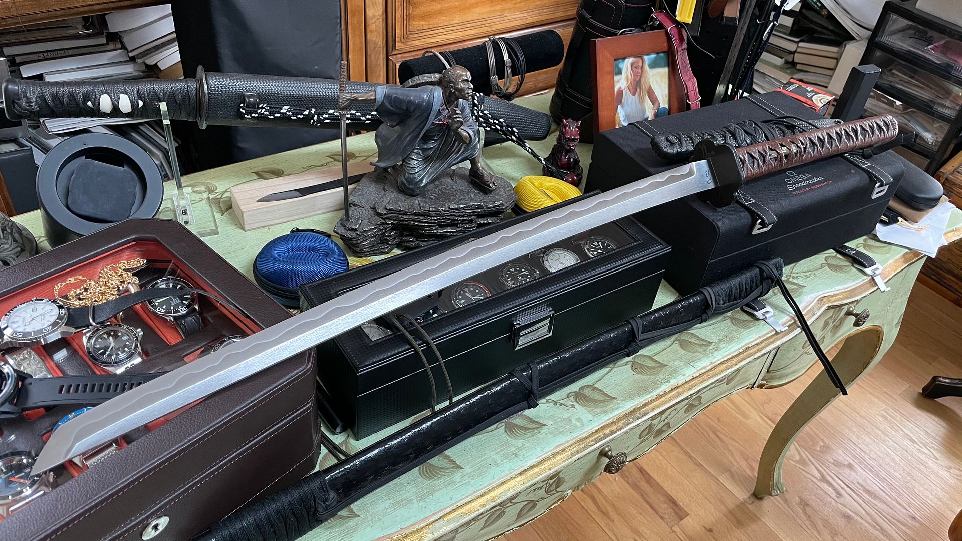

By far the sharpest swords I have seen and I’ve seen a lot came from the late great Phill Hartsfield
His knives were not slouches either but when it comes to swords no sword that ive seen and ive seen Angel Swords work for years cuts like a Hartsfield
It’s a mixture of edge geometry and heat treat but Phill’s swords were mythical in cutting power

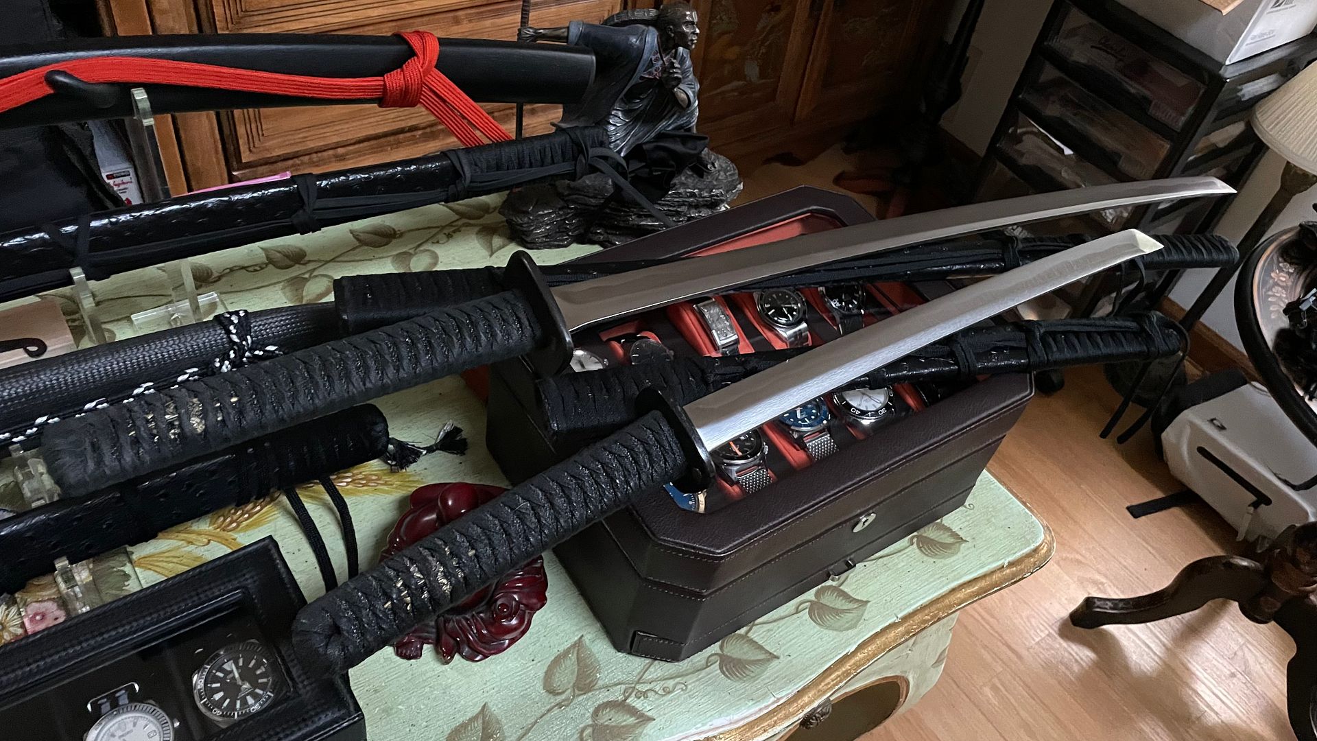

Hands down best/sharpest sword. RMJ Wyvern. Anyone who hasn't tried one has to do that. Life changing. Bow to your Sensei.
