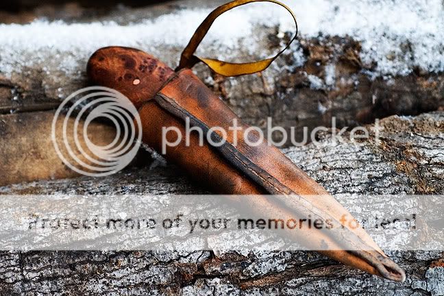

Forging wrought iron wraps for the scabbard:

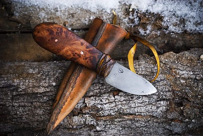

Here it is after quenching and fitting wrought iron guard:
And... drum roll... Lady's and Gentleman let me introduce you to my first sword!
You now how these things go. You start grinding, you make some mistakes and a 14" blade turns into a 2.5" utility knife. Oh well. Nice patterns on the blade eh?
