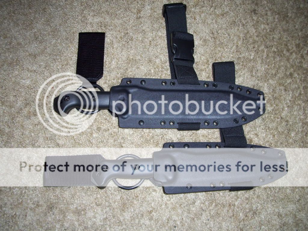

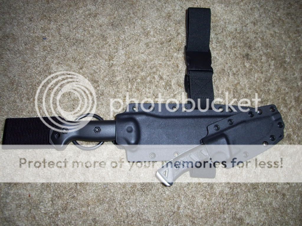

Here's the one I got off Nick awhile back. Nix leather, I think it is now.
Here's a better pic.

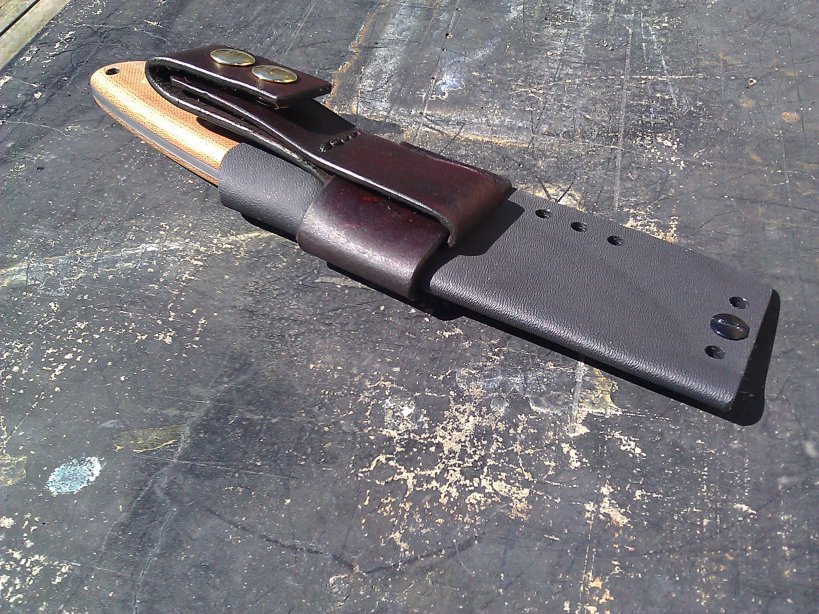

Here you go. Two snaps in the belt loop lets you go either way. :thumbup:

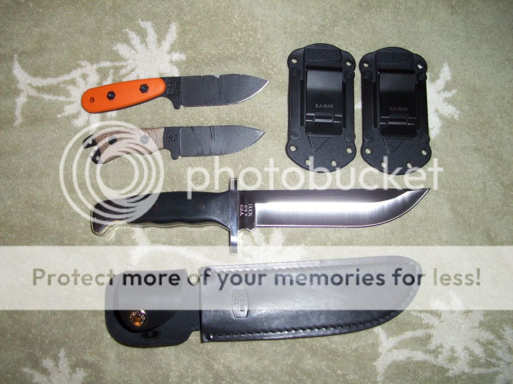

this guy was something of a convertible/crossover, and could go full dangler or fully tek-lok:
