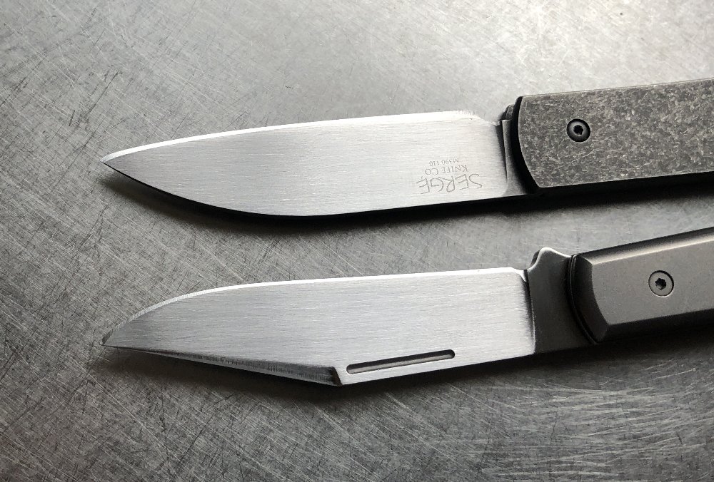

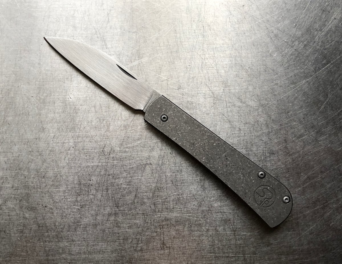

2. Design
The blade shape is modified Wharncliffe with slight curvature, which I really like.
It has a stop pin like the other modern slip joint knives I have.
However, the pin is slightly short and therefore rattles.
I had to put some grease to stop it.

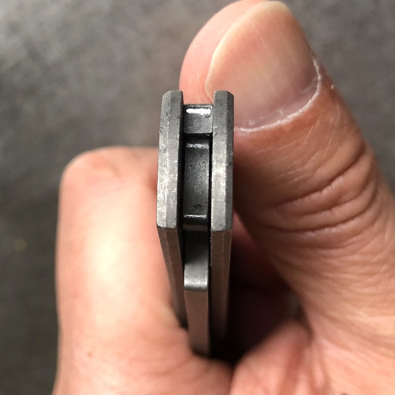

One thing I find interesting is the blade tang design.
It is not flat but has a dent.
I don't know what the benefit of this design is.
You can see the line-shaped hit mark of the spring.

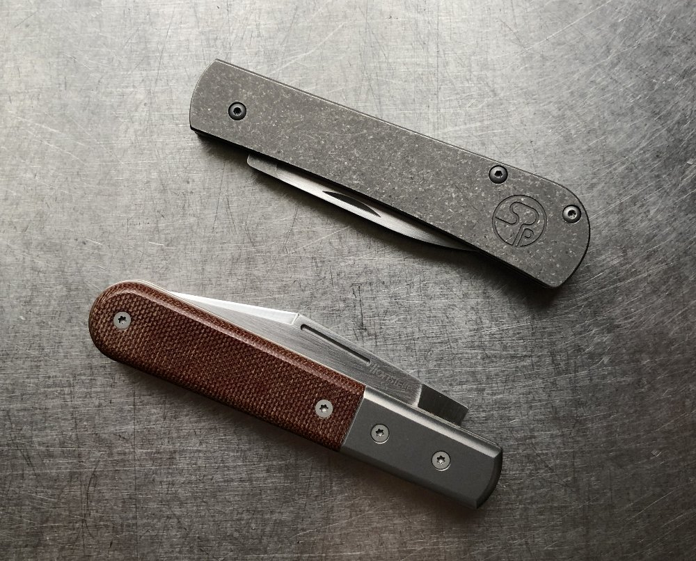

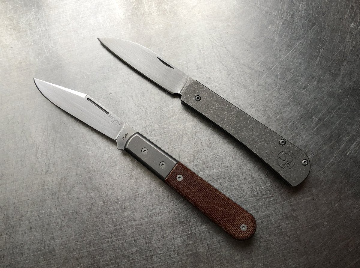

3. Size
Size-wise, it is between GEC #15 and Shuffler.
Really good for my EDC.
The best thing about the size is its thinness and narrowness when closed.
Also vert light (<2 oz).
It does disappear in pocket.

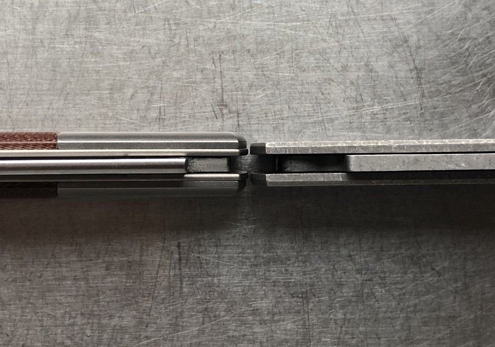

4. Fit and finish
Dead centered blade.
Everything is chamfered or rounded.
There is no gap between the handles and the spring.
It feels like $150 knife or even better.
The only gripe so far is the rattling stop pin.....
