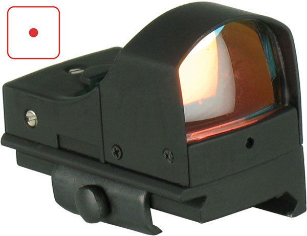

hey, i just got a sight mark mini shot reflex sight for my 10/22 and zeroed it yesterday.
so far so good.
my first question is, does anyone else have any experience with this sight?
what is the expected battery life on this model? the website and/or instructions mention nothing about this.
it's this one
http://sightmark.com/index.php?main_page=product_info&cPath=3&products_id=8

if that's actually the case, that's kind of crummy. a red dot sight that lasts an hour -- that's crazy, and i would NEVER recommend it to anyone. aimpoint CCO's, albeit 3-4-5 times the cost, quote battery lifetimes past the tens of thousands of hours.
but the good news is, i've left this sightmark sight in the "on" position since i received it in the mail yesterday. it's been on for 24 hours now and still glowing.
updates to follow when/if the battery dies.

still glowing. 17 days left on-constant, no change.
a little disappointed, however, i zeroed the weapon at ~50m and was shooting at targets yesterday, give or take at ~25m and the scope appeared not to hold the zero.
i understand that with the scope zeroed at 50m and shooting at distances less than 50, there will be a change in elevation. but this time it was shooting consistently low, and about 4 inches to the left.
i'm going to give the scope the benefit of the doubt that, perhaps it was the change in distances that caused a shift, or that perhaps the scope had been jarred or dropped (i allow other shooters to use my .22 all the time). i will rezero next week and try again.
on a side note, zeroing this scope is a PAIN. the adjustment knobs have ZERO resistance when you turn them, so it's impossible to accurately make adjustment in a incremental scale. no clicks, no nothing.
back to the top, still glowing, but when i went to shoot it this weekend, the red dot would flicker upon the .22 recoil. induced by the diminishing power in the battery, perhaps?

Usually that happens when it loses the connection due to a gap between the contacts and the battery. If it has a spring, you can try stretching it out a bit to see if that helps.

nah, i'm going to call this one quits.
as storl said, the reticle may flicker when the battery loses connectivity with the leads. in my case, the sight is a little difficult to maneuver for battery changes. nothing too complicated, use an allen wrench to unscrew two screws, then the whole top of the sight lifts off. it does not come off all the way, and from what i can tell there is some sort of elastic holding the back end down. i will not tug on this for fear of damaging the device.
so i just slid the old battery out and slid a new one in place, within the small gap that was available.
all things considered, the battery life isn't bad.
again, left it "on" for 46 days, medium brightness.
the reticle flickered or went out when i was firing .22. i would jiggle the on/off switch from off--high setting, and the reticle would come on again. it's fair to say the battery was on it's last leg.
replaced it with a new CR2032 and the sight comes on just fine again, no flickering, and the operation is normal.
