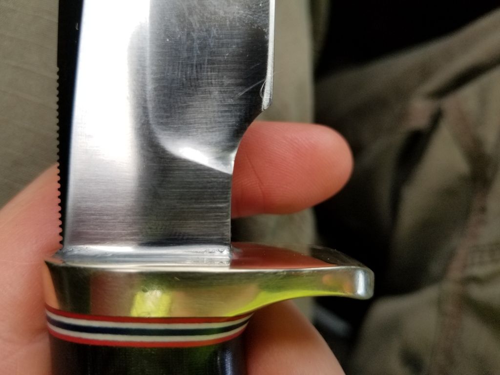

So the black pin holes that develop on some or most knives hilt solder... Is this just cosmetic or is it because of an air gap within the material. I know I've used knives pretty hard, one knife looked as it had a less than hairline crack or mark on it but it never got worse or changed.
I use my Randall Made knives hard as you will be able to see on my prior posts. The soldered hilts never failed. The reason you see natural deviations from the soldering process on the surface is because the area is too small to file. Hairlines on the surface seem to be normal as my knives have them as well. Just use and enjoy the knives and don’t worry about the solder.

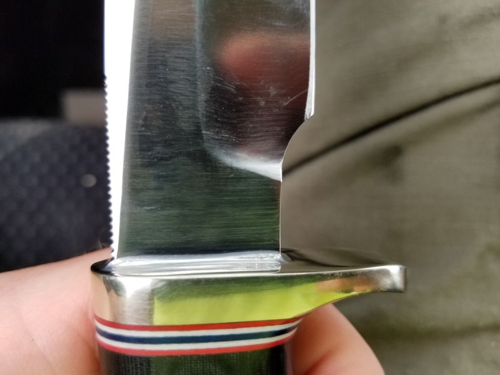

After some use the soldering has changed to what I remember. Perhaps just another way to tell if a knife was used.
Same exact knife. The Mark's are on the spine and bottom too. Again this has happened on all of the Randall knives after a short while. I don't think it's a major defect as it's just a water proofer and its assuredly still water tight.
