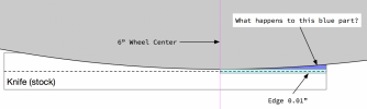

Sure is a lot of history here, all I know is it cuts like the dickens and the edge lasts a long time. Thank you Nathan! Your work has been appreciated .Some of the skinners were around .010" at the edge, ground above tangent (like a straight razor) and sharpened around 13 DPS in hard D2. They would flex some over your thumb nail and a couple would ring a little when stropped. They'd pop a free standing hair and would slice through meat and hide like a light saber. When pulling the hide off the rib cage there's a few little muscles that attach the skin to the flanks that you sometime need to cut or they'll tear meat that you may or may not care about. These could be severed while under tension with a tiny little tap of the blade. When pulling the intestines and other bits from inside the pelvis (I don't cut these, I tie them off) there are bits of connective tissue holding them in place than could be severed with the lightest touch of the blade. I'd hold the butt of the handle in the palm of my hand and extend the blade out along my index finger like an extension of the finger and disconnect bits without pulling on them like a magic wand. These blades were sharp and stayed sharp though an entire season of use (no need to resharpen during a hunt) but you did not want to use one to split a rib cage or pelvis, they weren't built for that and you'd loose a chunk out of the blade.
