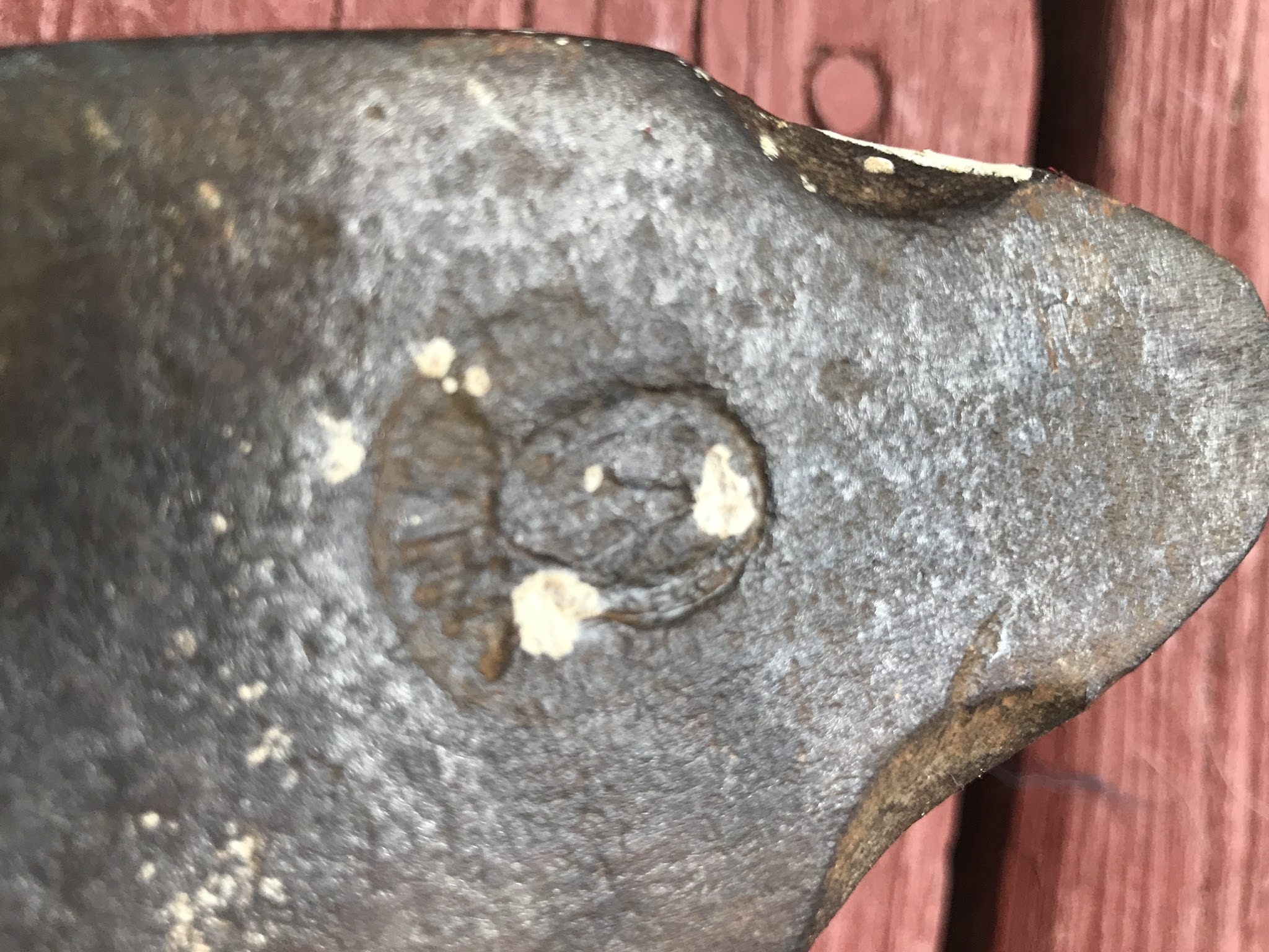

any idea what this guy is? the marking is an A inside a horse shoe with letters in a "wreath" underneath.
This is a nice old head on a new handle. Both were flea market finds and I'm into this project for $3.50. :)
IMG_20170808_182642 by Justin Lyttle, on Flickr
IMG_20170808_182649 by Justin Lyttle, on Flickr
IMG_20170808_182701 by Justin Lyttle, on Flickr
IMG_20170808_182716 by Justin Lyttle, on Flickr
IMG_20170808_182709 by Justin Lyttle, on Flickr
