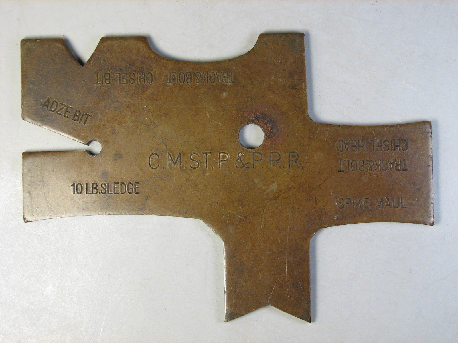

A track chisel should have a more rounded bit. My hunch is that you'll lose the heel and toe to chipping if you go at it with that.
Also, I don't think you'll be successful actually dividing a 3 foot piece of track by that method. My understanding is that the track chisel was used to score the track all the way around. Then the portion to be removed was cantelevered over a tie and hammered hard with a sledge, tearing off the section track along the score line. The remaining end needs to be stable enough to resist the hammering.
If you hope to make this cut you'll need a means to stabilize your rail for the hammering.
BTW, many people claim that RR track is hardened (usually when talking about how it makes a decent anvil substitute), but it is not. The top may become work hardened, but RR track is not hardened steel in the way that people think.
This is what I've read, too. Not hardened. But it's supposed to be high carbon steel. Old track was said to be 1080. Weygers, in his book 'the complete modern blacksmith' describes how to flatten and harden track for use as an anvil.

Pennsylvania RR specs look very similar to my CMStP&P tool gauge. Very rounded cutting edge.
Care of the tool is described here by a major maker of railroad tools.
http://cedarriverforge.com/Photo-index/Tools/Railroad tools/Hubbard-complete.pdf

I am impressed with the language and examples of right and wrong as well as the image of a poorly ground chisel.
The track pieces show just how much fun it must have been and is still to score that rail. What pressure to score and then sever under the time schedules demanded...with a load of passengers mulling about waiting.
