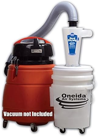

OK, so with all that info out of the way, what I'm considering buying is a dust deputy, and this Harbor Freight "portable" dust collector (see below). I was also planning on putting an inch or so of water in the 5 gallon bucket that the dust deputy attaches to ta help put out any sparks. There are just so many different set ups out there it's overwhelming, especially since I don't have any experience with them. But my space, power, and noise limitations make it even harder to choose a dust collection system, and of course my budget as well.

First the dust deputy, I'm sure most guys have seen them:
http://www.amazon.com/Oneida-AXD000..._UL160_SR115,160_&refRID=0WSWWANVXX99VQ3KD83H
And then the dust collector that I would connect to the dust deputy:
What really interested me about this dust collector is that for one, it takes up very little space, it's "only" 7 amps and it's specs say it has ~10 times the suction of a typical shop vac. Plus it has good reviews, apart from some guys who've bought one to use "as" or in place of their shop vac. I'm also guessing it's a lot less noisy, at least compared to the Ridgid shop vac I have, but I could be wrong.
http://www.harborfreight.com/13-gallon-industrial-portable-dust-collector-31810.html
