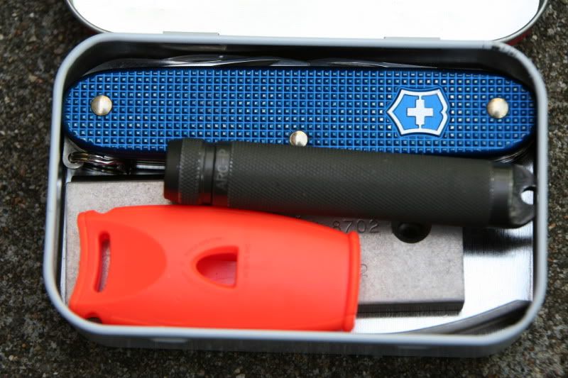

I see a few custom fixed blade knives that are designed to fit in an altoids tin... often costing $50 or more. I see there are some production knives that are designed to fit in an altoids tin for a reasonable price, but the steel is *VERY* soft ( 52 on the Rockwell C scale ). I have seen a few places where people have made their own knives from hacksaw or sawzall blades... but I have no way to heat treat them. So...
Has anyone considered taking a mora knife, removing the handle and grinding the blade/handle to a length that will fit an altoids tin and a shape that will fit your hand? The overall length should be around 4.75". Some of the blade will end up being ground down to be a handle. I should be able to do this without ruining the heat treatment if I am careful and keep the steel cool. My brother has a low speed grinding wheel in a water bath that should work well for shaping. Does this sound reasonable?

Sounds like it'll work to me, though I'd wince as soon as the edge touched the wheel, no idea why the blanks are more expensive, and unless your planning to try and save the handle go with the clipper
I'd be loathe to ruin a knife too... But what you're talking about isn't ruining it, just re-purposing it. Grinding a blade down into a handle shape isn't too difficult, so I'd say go for it. Just remember that you can always grind more - you can't ungrind ;)

I know you said Fixed blade. So please forgive me for this, theSAK Soldier in Alox fits beautifully against the edge of the tin, and is less than .5" wide. Why try to source a fixed blade that fits the constraint of the box, and lose the function that makes the fixed blade appealing? Plus the SAK gives you 3-4 more tools.

Have you considered grinding one (carefully) out of an old file? There is a plethora of info on making "Po' boy" knives out of tempered and ground files. If you were very careful, you could end up with decent (and stout) little cutter that could also be used as a striker. I'm thinking something along the lines of a 2" blade and simply squaring off the shoulders at the tang before giving it a waxed nylon wrap for comfort. With a little luck, you'd have a stout knife big enough to slice, stout enough to open a can, you could strike a fire with it, and the waxed nylon thread grip (like you use in leather work) could be unwound for emergency fishing/trap/shelter building line. It's really strong stuff.

Im actually really liking the Mora idea. If you screw it up your only out $10. I would say maybe use a stainless one since its going to be just sitting in a tin all the time. And I would add a secondary bevel because its not a wood carving/bushcrafting knife anymore, its a last ditch survival.
I could go with a small folder, but I worry about the strength of most. There are some sturdy folders, but they take up a lot of room. I realize a fixed blade knife that small will be very much a compromise, but it will be strong enough to survive some abuse. As for a hacksaw blade knife... I worry about the hardness. I don't have the equipment necessary to heat treat the blade, and I believe the only part of a hacksaw blade that is hardened are the teeth. I have the same worry about ruining the heat treatment of an old file...
