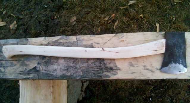

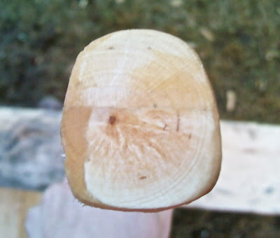

Pecan is a type of hickory. This photo shows a homemade axe handle, 24" and made from 3" diameter birch (not as strong as the hickories), that works just fine, according to the linked article:
http://axeconnected.blogspot.com/2013/03/weak-handles-revisited.html
