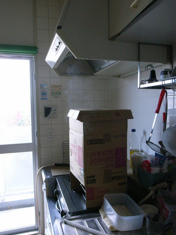

This is a great thread. I've never tried one in the field but I built this thing last week.
Pork rib is being smoked there. I'll post finished thing later ;)
