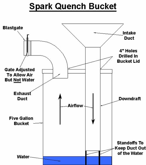

Here is a drawing of a spark arrestor bucket we've been using for several years. The difference is the blast gate on the outlet. Our dust collector is 1800 cfm. It will pull all of the water out of the bucket in a few minutes. We use the blast gate to reduce airflow until the water stays in the bucket.
Be sure to keep water in the bucket. We've had some exciting fires when the bucket went dry. Titanium and steel dust mixed together burn very very well!

Well, i got this hooked up with a 4" intake as well as 4" out. and i'm suckin up water. is the blast gate about my only option?

And i'm suckin up water. Is the blast gate about my only option?
We had the same problem of sucking up water. Using the blast gate to limit the airflow solved the problem. We open the blast gate all the way when we are not generating sparks.

how much suction are you getting with the blast gate?? i made a makeshift blastgate until i pick one up this weekend. but when i restrict air flow just to the point that i'm not sucking up water i have barely any suction. to be honest the shop vac was working better. would a bigger bucket make a diff?
2 things come to my mind. Try to make an adjustable opening on the arrestor box. That will lower the pressure in but you'll suck some ambient air around the arrestor which may be good. Also I'm not sure but you use bigger downdraft pipe and get it a bit higher than water level...

My arrestor system is almost exactly what emre has drawn. The downdraft pipe needs to be higher off the bucket floor. Mine is about 4" above the floor.
