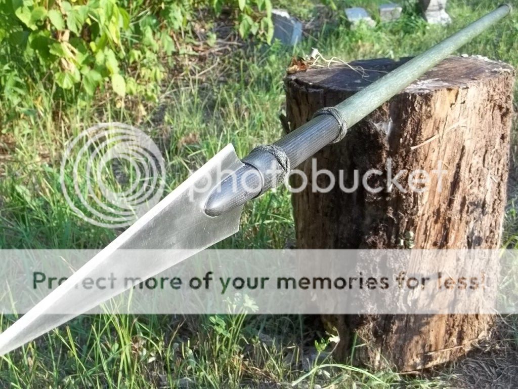

piece name: SD Spear CF Ti Prototype
date of completion: July 2012
blade material and hardness: 6-4 Titanium alloy, ELI
blade surface finish: Field Finish
handle material: vacuum epoxy impregnated carbon fibre over solid wood core (seamless unidirectional, then seamless 45 degree, double 45 degree over tang area plus 3", 0/90 degree carbon fibre collar with seamless 45 degree over)
other materials: stainless steel pins, abrasion resistant epoxy texture coating
overall length: 69.75" (10" cutting edges)
maximum blade thickness: 0.080"
weight: 1lb 10.4oz
sheath/scabbard: Kydex
general description: spear
special features: Besh inspired blade with 20 degree zero grind. Cutting width 2.88". Abrasion resistant green texture coat to reduce thermal gain and improve grip. 3 Turk's heads for grip indexing. Hidden pins. Slight flex-bias in cutting plane to reduce shock during slashing. This spear was designed for lightweight, untrained users as an improvement over the sharpened stick and doubles as a walking staff. Strength of the shaft far exceeds user hand strength, blade is optimized to cause damage during panicked gross motor movement.
original selling price: gift for my wife (she can shoot but doesn't usually carry)
notes for care and use: primarily for stabbing in self defence against wild dogs and black bears
