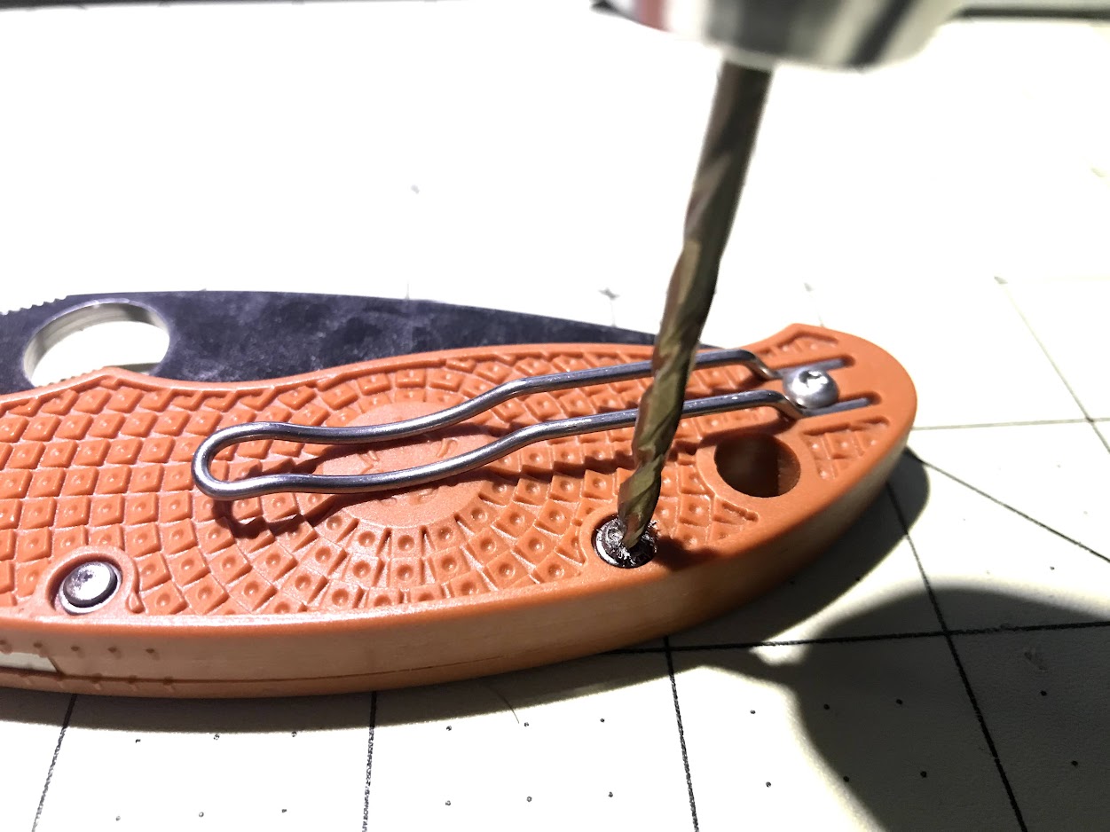

Hello Everyone!
I recently purchased a Rex45 Manix 2 Lightweight. Out of the box the knife was extremely stiff and required two handed opening and closing (see video below).
I love the Manix platform but I also really love taking my knives apart and tinkering with them, so this knife was a pretty big letdown at first. Even with the pivot screw removed completely and oil dripped right into the pivot, the knife was still a two hand operation and not fun to carry.
I took off a chunk of finger trying to one handed whip the knife closed. After that I knew I had to convert the knife body hardware to screws so I can tinker with the knife to get the action more to my liking as revenge.
To my surprise I didn't find much information on the procedure. I found a LOT of people inquiring and getting discouraged by other members saying it was not worth the effort. But I found uxo2's thread documenting his Manix 2 Lightweight conversion and it was extremely helpful.
So for this thread, I wanted to build on what uxo2 had done and make a more in depth guide with a bunch of photos so people can have another source of information to draw from if they want to also complete this mod themselves.
Hope you enjoy.
NOTE: Doing this mod will definitely void your warranty and it is definitely not plug and play easy. So please consider this before attempting.

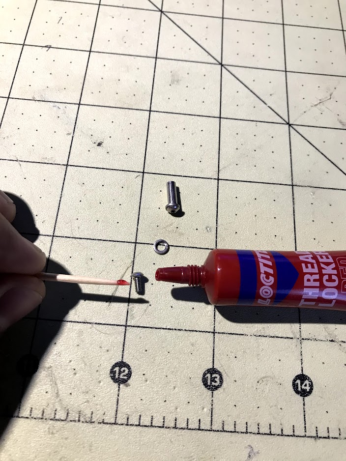

- Barrel Pivot Pin - 1/8" x 3/8" x 2/56" Thread
- Pin Vise Hand Drill
- Drill Press (Will save time and frustration)
- Automatic Center Punch
- 1/8" Drill Bit (for drilling metal)
- Small Metal File
- Method of keeping small screws and pivots steady while filing. I used a threaded screw checker.
- Rit DyeMore Liquid Dye
