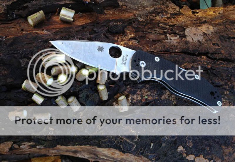

This version, however, has a lovely FFG blade and only a subtle swedge. The G10 and steel liners add to the quality feel at the expense of weight. The fit and finish of my specimen is exemplary: the newly engineered back-lock feels secure and despite no "Boye-dent" I cannot conceive of a situation where I would inadvertantly disengage the lock during use.

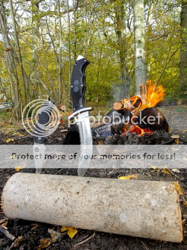

In all, the Native has "grown-up". Pictured here (middle) with a UKPK and a PITS folder:

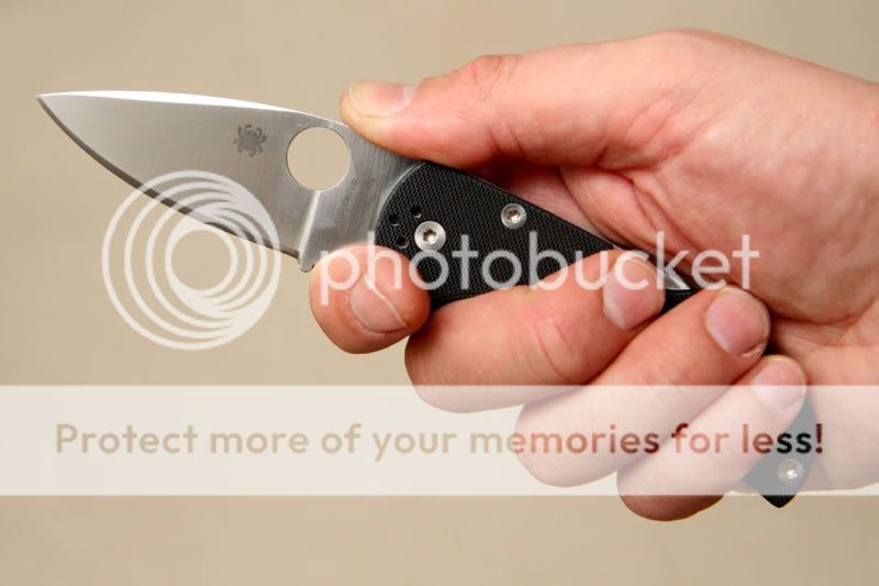

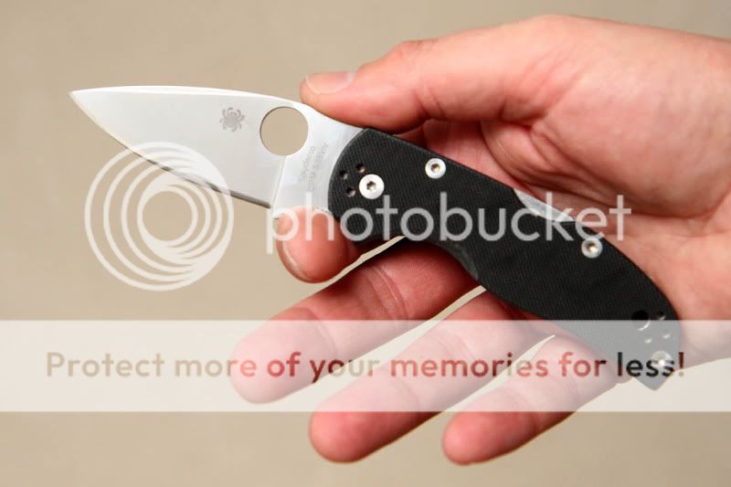

In Hand: Jimping aids index and thumb grip
The effective hourglass pocket clip has a polished finish and has four-way mounting options. In tip-up positons it sits over the lanyard hole; tip-down it allows access to the pivot screw. The G10 is grippy but doesn't shred pockets, so far. The liners are heavily skeletonised and are seperated from the blade by phosphor-bronze washers. There is no blade play after approx 8 weeks use.

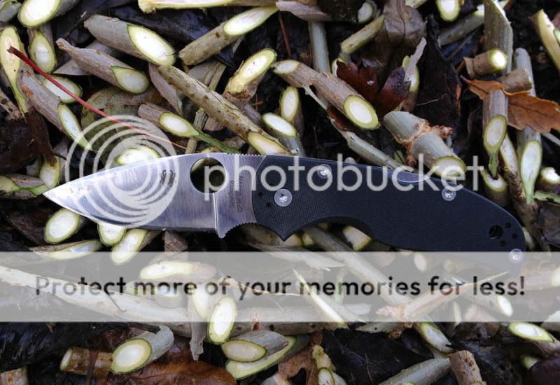

Whittling:

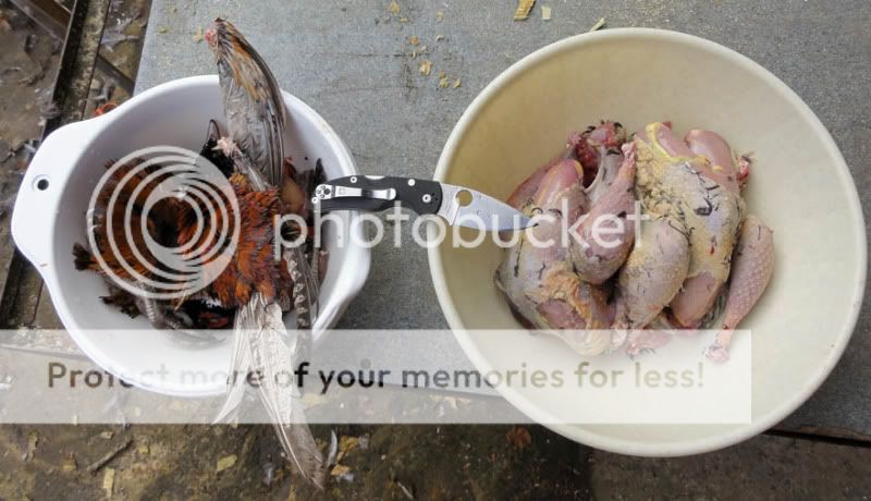

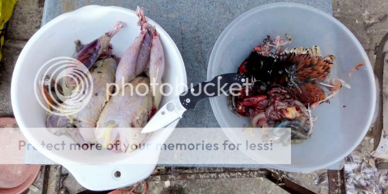

Game prep (four birds total- 3 cocks, one hen):

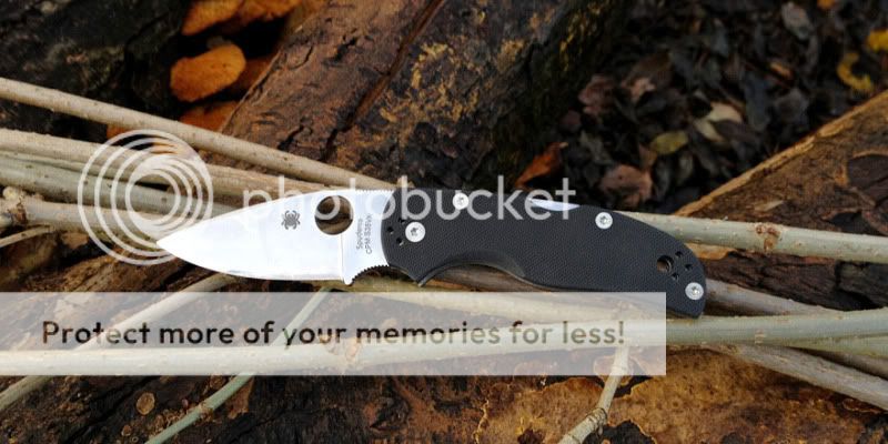

I also made some feather-sticks a fire:

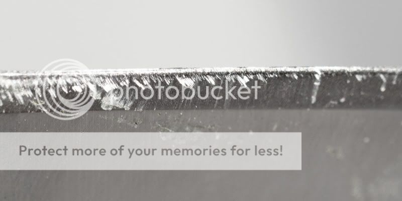

I took some macro pics of the edge and there were some areas of very slight deformation of the microbevel:

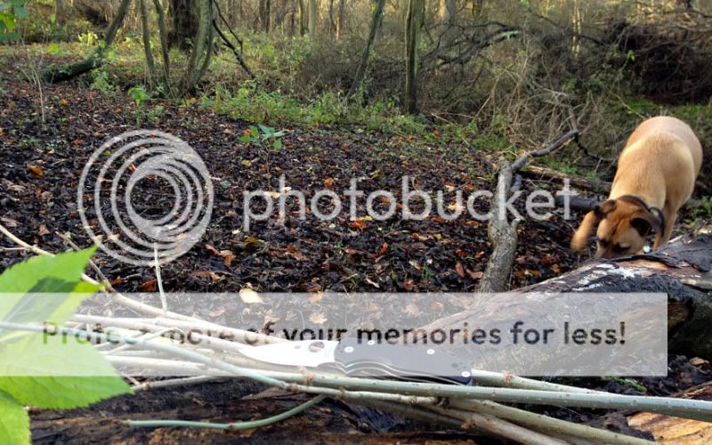

After the fuss about S35VN rolling, I decided to stress the area of slight damage with some specifically targetted, multiple (300+) cross-grain push-cutting onto a log and slicing (albeit on soft green wood):

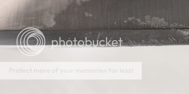

Macro reveals slight rolling but nothing dramatic:

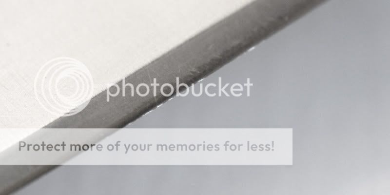

Edge-on view:
It will still shave loosely held paper (using the area of deformation) but has a grittier feel and there are paper fibres sticking to the edge (not well seen in the pics but I don't have macro capability at present, hence phone pics for these.)
It will no longer shave forearm hair but is cutting well and feels sharp.

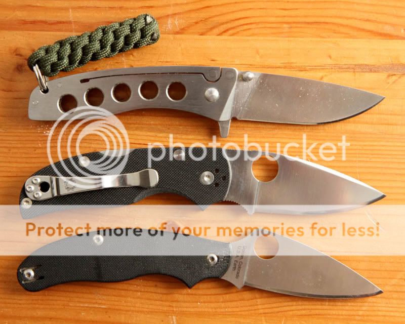

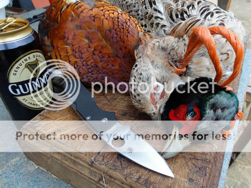

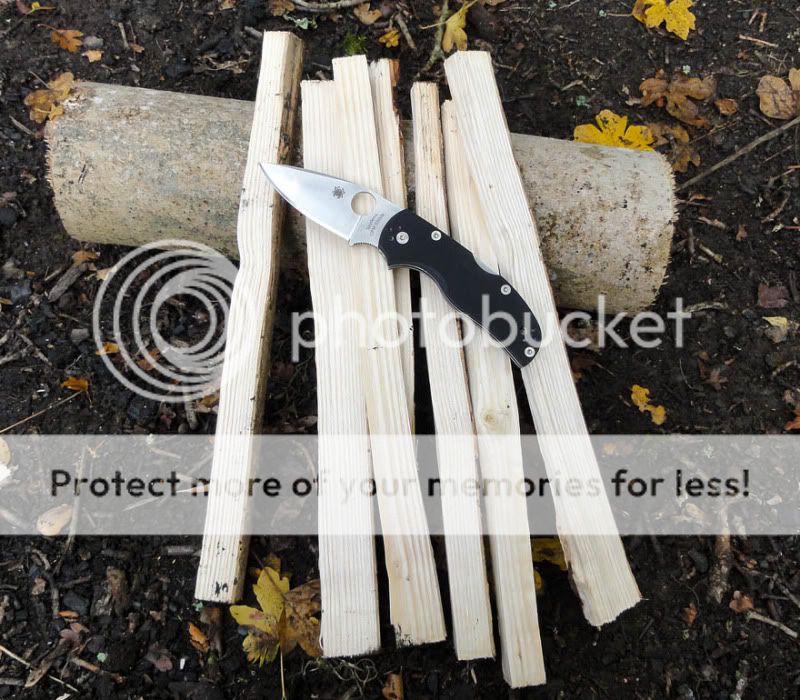

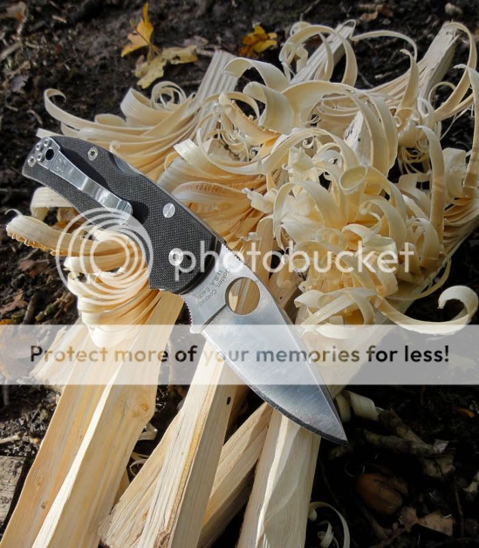

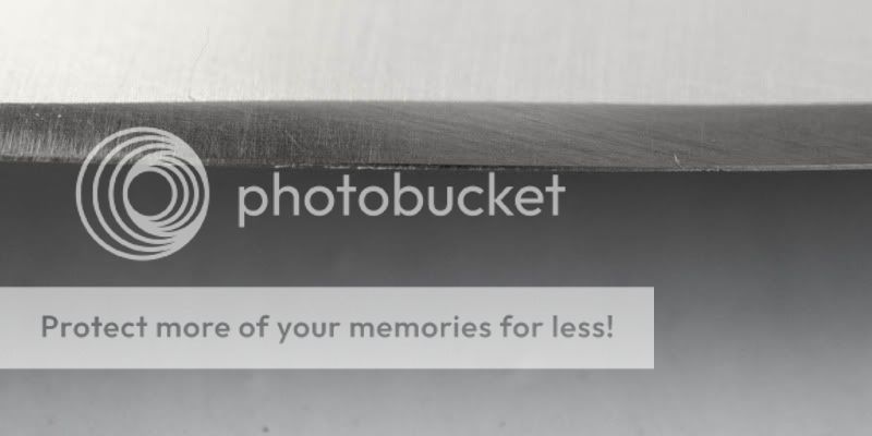

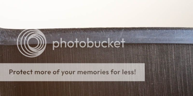

After this there was no gross damage to the edge:

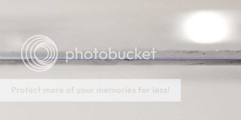

Edge-on view:
