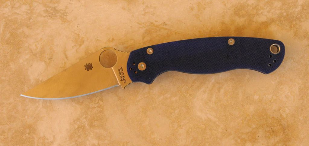

Spyderco PM2 in s110v
Would you mind telling me (us) what compounds you are using on your super steels to strop with? Are you just loading those compounds onto a bare strop?
Thanks in advance!
Drew

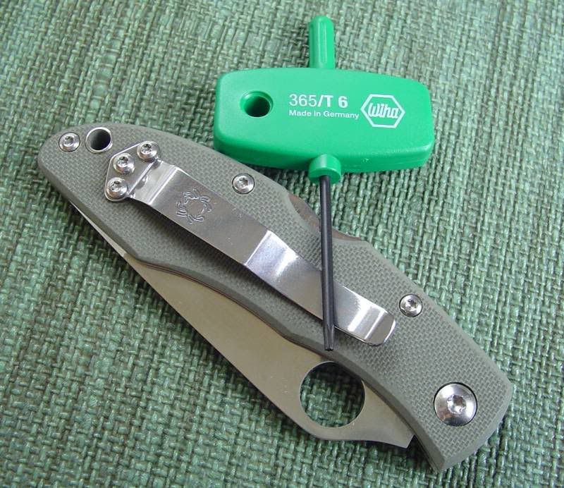

Torx T6 should do it.
I highly recommend the Wiha Butterfly wrenches in the smaller Torx sizes. Or the regular Wiha wrenches if you don't mind something larger. They are called "precision" wrenches for a reason; they are FAR less likely to slip and round out/deform the screw due to their tight machining tolerances. Perfect fit! :thumbup:
(Image not mine; but this is the wrench. Taken from a thread on the same subject over on the Spyderco factory forum.)

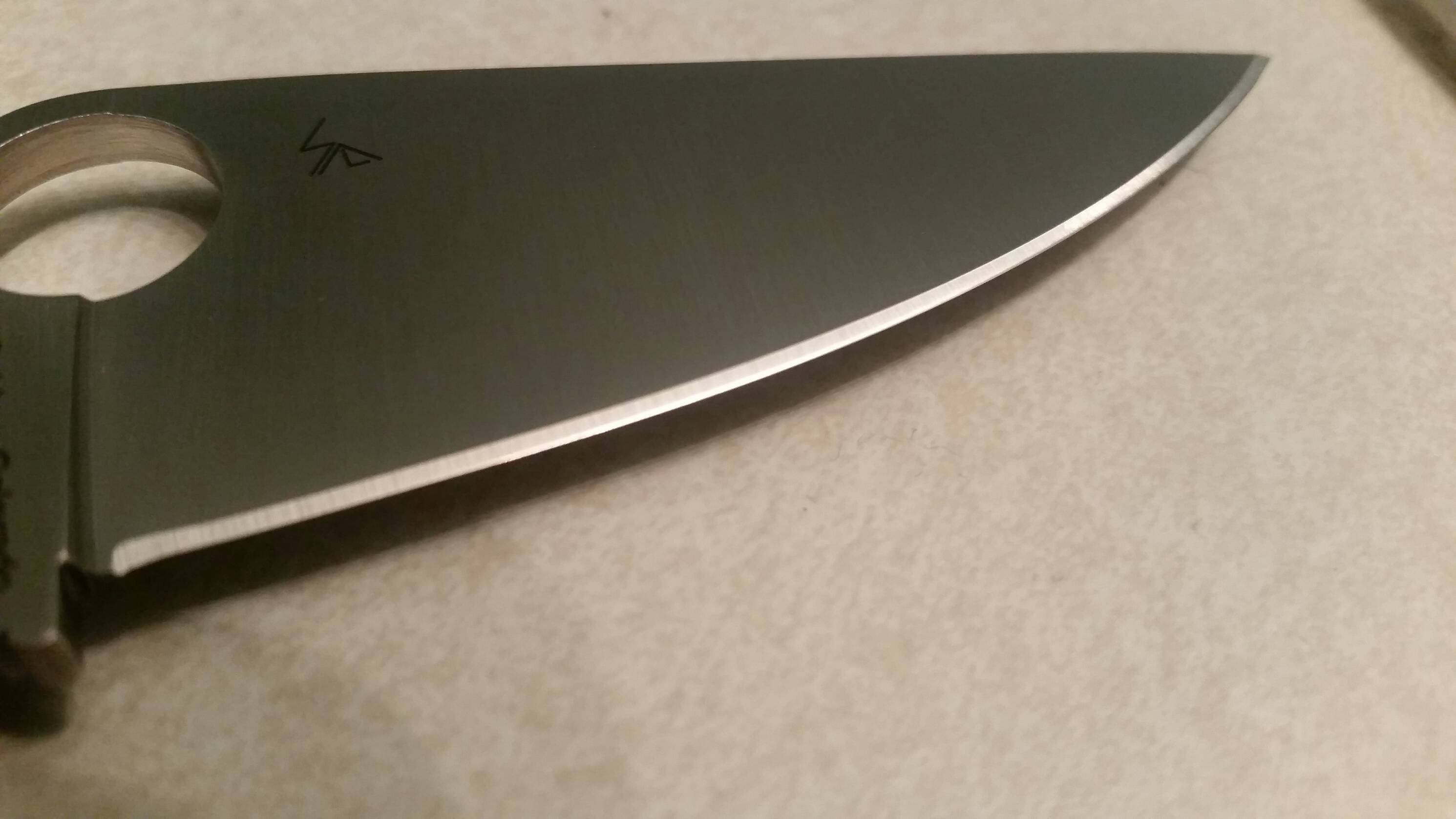

I can get some of these higher-end super steels pretty darned sharp (hair poppin'), and they seem to hold that edge for a good amount of time. However, I can't seem to get as good of a mirror-polish on their edge as I can with steels of lower alloy content.
As an example, I finally sharpened my S110V PM2 a couple days ago, and the edge is fantastically sharp, but lacks the mirror polish I am usually used to seeing and also doesn't seem to have as "fine" of an edge apex as I would expect. Definitely feels like a more toothy edge than it should be, even after stropping. Green chrome on the strop essentially did nothing for it. But it sure is SHARP!!! :eek: Sounds like I need to pick up some 3-5 micron diamond paste and another dedicated strop to use it on.

Yeah, that's about how my edges normally look (not quite that polished though). I'll have to give the diamond paste a try on a leather belt. This is the first steel I've come across that would require that.
I just looked, and I already have a spare leather belt (that I don't remember buying, lol), so I just need to get some diamond paste. Which diamond paste might you recommend? I think I'll probably go with 5 micron, but maybe 3 micron.

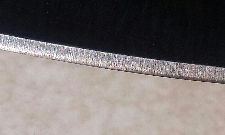

A buddy of mine brought me his pm2 in s110v to sharpen for him...he'd taken it on a camping trip and beat the hell out of it he said...it still had a fairly sharp edge thou not razor sharp anymore. He did unfortunately make contact with a rock so there was a small chip in the edge which was the reasoning for sharpening.
This being the first time sharpening this steel I was expecting the worse, but was surprised to find it grinds fairly easy, Easier than s30v imo. It took me maybe 15-20 minutes on the wskt-ko blade grinding attachment to get the edge squared away. He didn't want it polished so I ground the bevels at 15dps then put a 20dps micro bevel per his request. The x64 belt worked great and afterwards took a few passes on the x4 belt to remove any remaining bur.
If you have diamonds it's not hard to get that sharp working edge that most people like on a steel like s110v up to let's say 600 grit. Unless your going for a mirror polish, getting rid of all scratch patterns from previous grits ect... I was able to get a mirror polish on her but it took over an hr, Mabey 2 while watching tv using kme sharpener, diamond stones and 4 micron then 1.5 micron cbn emultion on strop. Can't wait to get the finer cbn.
