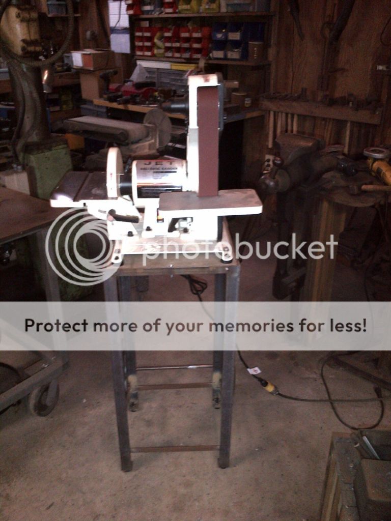

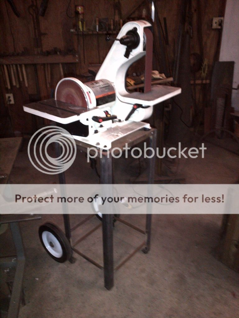

I actually want to make something as opposed to buying it. I like making things so much I'd gladly spend more to make something than to buy it. One of the saddest days in my life was when I finished this boat:
I was thinking of a frame made out of angle iron, and maybe two lawnmower wheels mounted just slightly off the ground so that you could tilt the stand back slightly and roll it on the wheels.
I picked up at sears a tool stand and bought their wheel set up for it. You can set up the height just right for you and locking wheels helps a lot. Read about clamping it to the workbench, good idea... but I roll it out of the garage to keep the dust down.
Here's what I did. I made the legs out of 1.5"X1.5" angle iron. The top is 1"X1" angle with a piece of 3/4" plywood sitting in it. I had a couple of 10" lawnmower wheels (the kind with the steel wheel, not plastic!) which I made some brackets for the back legs, drilled 1/2" holes in them, and ran a piece of 1/2" round through for the axle. The wheels are mounted only slightly above the floor level, maybe 1/4". Here are a couple of pictures:
