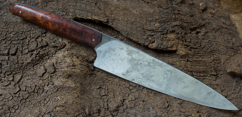

The kitchen knives were ground from 1/8" stock to an edge thickness of .012". The edge bevel is about 10-degrees per side, finished on a progression of stones to the 8k waterstone, then stropped with 100k diamond and untreated horsebutt. The razors have an asymmetrical hollow grind to an edge thickness of .007" and have zero-edges. Edge finish on the razors is the same as the kitchen knives.
I would only consider a blade as being "razor" sharp when it gives you a truly comfortable shave. The kitchen knives do not do that, due to the (relatively) obtuse edge geometry. The CPM M4 razors, on the other hand, do provide very smooth shaves, and they are holding their edge better than any other razor I've used.
