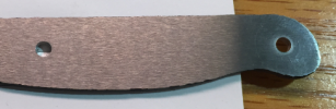

I might have outsmarted myself: I have always thought in terms of drilling rivet/pin holes prior to HT ... but a couple of comments by people saying "sure, you can drill hardened blades" caused me to thing "at least try it." well, now faced with it (this is specifically about the 15n20 blades JT just produced) has me reviewing posts on the web. At least one earlier thread on this forum indicates it is doable with carbide drills (maybe several) ... but quite a few posts elsewhere on the web basically say "dream on". (I was also confused as JT's ordering system allowed for an "I will drill rivet holes myself"). So ... what is the current wisdom out there: should I go get some carbide drills and at least try it ... or should I do as Boye recommends, and take a blow torch and try to anneal the handle (problematic - these are small knives and I really risk also annealing the blade area). Please let me know your thoughts??

You have several options. As you already mentioned, the solid carbide drill bits will easily drill through hardened steel, but they are brittle. You can anneal the tang by heating it to a dull red 2 or 3 times (keep the blade cool by submerging in water, or a wet rag, etc). Or, you can go buy a carbide tipped masonry bit. They will absolutely cut through hardened steel being carbide tipped. I've done this a handful of times. Buy a few of them, they're cheap enough, sometimes the carbide tip will snap off. Oh BTW, the hole of a carbide tipped masonry bit will be slightly oversized, but I always drill oversized holes anyway.

The way to drill hardened knife steel with carbide bits is partly technique, but mostly using the right bits. I use three and four flute carbide bits and drill the holes effortlessly. Speed should be moderately high and use firm downward pressure. Placing an aluminum or micarta backing block behind the blade is very wise. Clamp the blade down rock solid and make sure everything is square. If you have a mini-mill, this is a task they are really good at.
With a drill press that doesn’t have excessive play in the chuck it’s pretty simple. I use 2 flute solid carbide bits. I’ve drilled 15-20 holes with the current bit I have. As stated there are some techniques and tips that make it work. I clamp my blades to a 1” aluminum plate. My experience has been that a solid backer is a must. Most of the ones I break are right as the bit punches through the bottom side. I run my drill press around 300 rpm. I use a pecking method and a quality cutting oil. Since clamping to a solid backer I haven’t broken any bits.

I use Norseman carbide tipped drill bits. The shaft is high speed steel so it's tougher and more forgiving when chucked in a drill press. I use mild steel for a backer, available at Home Depot etc.

I have gone to drilling post HT for AEB-L since I always get wraps where the holes are drilled. I have been getting small 1/8" carbide paddle bits from Amazon for about $8. If I'm careful they last for a few holes. Once I have a hole I have better luck with masonry bits.

Success!!! Finally got my drill press set up (had to spend time stopping condensation from a cold water line that runs above it :( ).
Followed Stacy's advice - moderate speed, aluminum backer, everything well-clamped in place. For yucks, tried a cobalt drill (1/8") first, as some in other posts and forums have said they had luck with that. Did not even touch the steel (in fact the thing kept slipping in the chuck with the force I was applying).
Then tried the carbide (not tip ... full carbide) bit. It took just a little bit to get started on the steel ... but once it did it pretty much just churned its way through. I can see Stacy's point: firm continuous pressure - keep it cutting once it has started. Makes some really interesting sounds though. Thank you all! (if I keep doing this I am going to need to go after some of those inexpensive bits some have mentioned on Ebay).
