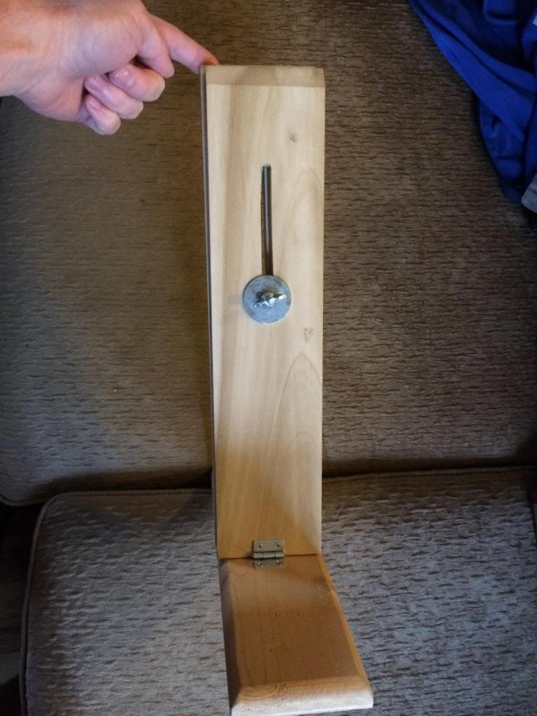

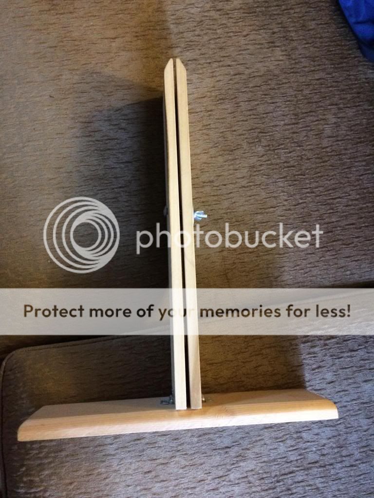

I made this for about $10 and less than an hour of work. Tall enough to put on my chair but short enough for some tables.
Very nice Alan. :)
