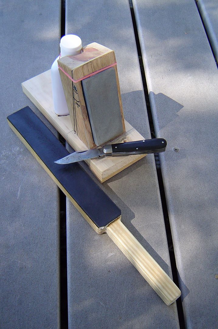

I'm looking to acquire a 3" paddle strop. I'm curious as to if I need a striping compound. And what you al might suggest. I'm finishing my knives on the ultra fine spyderco sharp maker rods and id like to refine and put the finishing touch on a strop.
No, you do not HAVE to use compound on a good strop. The leather alone will work.
A compound does making stropping on leather strops 1000x more effective imho.
After my waterstones I first use a (green)compound loaded strop and then finish with a bare leather strop.
Black compound: black emery
Then green compound: chrome oxide
Then Flitz metal polish.
The compounds should be very cheap if you look around a bit. They aren't some special, space age, exotic stuff.
Save your money for knives, get an old belt and glue it to a board, makes a perfect strop. Lots more info in the Tinkering/Maintenance section.

We knifeknuts decided we'd try something new and different, and following the lead of woodcarvers who do most of their daily touch-up sharpening on green compound painted ('painted' because they used ordinary green barn paint... [the green pigment is Chromium Oxide] ) on a paint stirring stick, took THAT to the next level and tried many different compounds on many different substrates. We discovered that we actually 'could' take a dull knife, and with the proper succession of different compounds, bring that dull edge back to sharp, and so "Voila!" we must have created a new and 'better' way to remove metal.
Better? No. Just different. Maybe more interesting than a succession of stones. Maybe not. Just different.
But after the fat lady sings (after the final extra-extra-extra fine stone, that is,) that's the original and still effective place for stropping. Chromium Oxide on a firm substrate, followed by bare high-quality horsehide. THAT is perfection.

Spending 30-45 minutes making one out of good quality vegetable tanned (so that it will take the 'casing' treatment to firm it up) leather produces a strop every bit as effective as any sold for use with compound.
Were it to be use bare... there we get into some interesting comparisons, as certain leathers contain higher natural silicate levels, smaller cell structures making the leather more dense, etc., but when using a stop with compounds, so long as the leather is firm and flat, all work well. If you purchase one, most of your money is going into the sanding and finishing of the wooden base, and the companies just slap on an unprocessed piece of leather, melt enough compound on to last a lifetime, and put it into a pretty box. There isn't a single knife-supply company that says that it cases its leather for the strops it sells. That means the resulting leather on the strop is not a firm as it should be, making it easier to roll an edge. You can prevent that by being careful when you strop... but you shouldn't have to.
Me? I don't need a finished wooden base, a pretty box, or four pounds of compound. I'll spend $5 on leather that I case and roll down to the density of wood, use scrap lumber, and crayon on just a wee bit of compound. Hmmm.... reading that makes me wonder why I don't just use the wood without the leather... that's what the wood carvers do!
