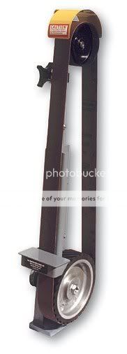

i think the only thing wrong with the harbor freight grinder 1x30 (Which I have purchased in the past) is that it moves WAY too fast and will heat up your blades like MAD. You want something much slower. I ended up saving some money and bought a coote belt grinder instead www.cootebeltgrinder.com. The whole setup will run around 500-600 bucks with motor, but you'll have way better control than something running 3450 rpm with that harbor freight dealy. Believe me i have tried, not something you want to use after your blade has been hardened and tempered as it will make your temper all fudged up real fast.

Maybe the Coote in conjunction with a motor you may already have or can buy local at a farm store and a set up of a couple of the KMG three tier pulleys in the bore you need, I think they offer them in 5/8, 3/4 and 7/8 bore to fit on the motor and the grinder. This would work to give you a variable speed option. All you would have to do then is mount the motor and grinder and find a belt that will work to run things.
Personally I like the pully set up better than the variable speed ones anyway just because of the torque issue. That way you have the same torque at all speeds basically where you lose some I think with the DC controller.

If you end up buying a coote, Norm coote also carries the step pullies for various speeds.....in the end, I only needed one!
