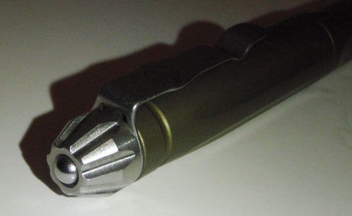

So, my only interest in carrying a SF pen over, say, a bic, is the glass breaker option.
Does anyone know what the glass breaker is made of?
Have there been any first hand tests done on whether the glass breaker actually works, or works well enough?

What makes SureFire’s Pen I unique is its hardened stainless steel tailcap tip. This tip can break tempered glass….pretty cool. Remember the MythBuster episode where Adam was pretending to be trapped in a vehicle that was sinking underwater and he had to do his best to escape. Well, with this pen you could easily escape a watery grave by using the tip to shatter the car window and swim to safety.
Has anyone ever tried to break a car window with one of these?... especially from the inside where your swing is very limited?

I have used mine on a small back door corner window. It took 3 hits for me to pop the glass. I just didn't give it enough whack the first two times.
I didn't have to use a full arm swing and could probably do the same from inside the car. The only problem would be putting your hand through the window. I suppose if your car is sinking or on fire then a few cuts to the hand are of little concern though. When doing it from the outside I stood with my back to the car and was able to use the window frame/door as a "stopper" with my forarm so my hand didn't go through the window.

I watched a guy try to break out a side window by hitting it 4 or 5 times and it did not break. He was swinging it pretty hard, too.
As mentioned, a better tool to break a window would be a ResQme or Houdini. A spark plug works very well, too!

The Surefire pen is a great pen, but the glass breaker is more a novelty in my mind.
I have both of the Surefire pens and I prefer the clickie version without the novelty ball on the end.

It was an old Toyota saloon that was getting scrapped (I don't know what the model was) The pen did break the glass so it managed the task it was asked to do. It wasn't exactly perfect for the job though. I don't know if maybe throwing the pen would be a better idea, I'll have to try that next time.
My friend also tried out the glass breaker on his microtech troodon, that worked pretty well too. The "bird beak" pommel on my ASH-1 managed to break a window pretty easily as well.
