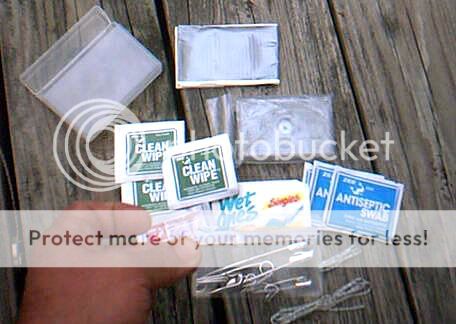

So what's in an urban kit????
Stainless maleable wire, duct tape, pins, bandaids, mirror, 4x magnifier, ointments and wipes. about the size of a cassette case. The one below is from travel Q Tips :)
