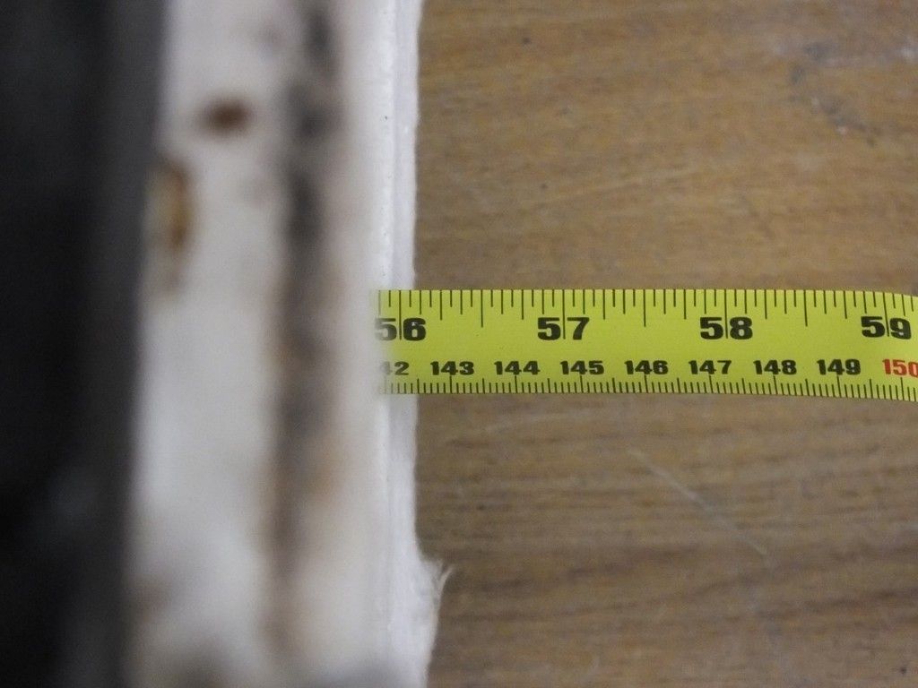

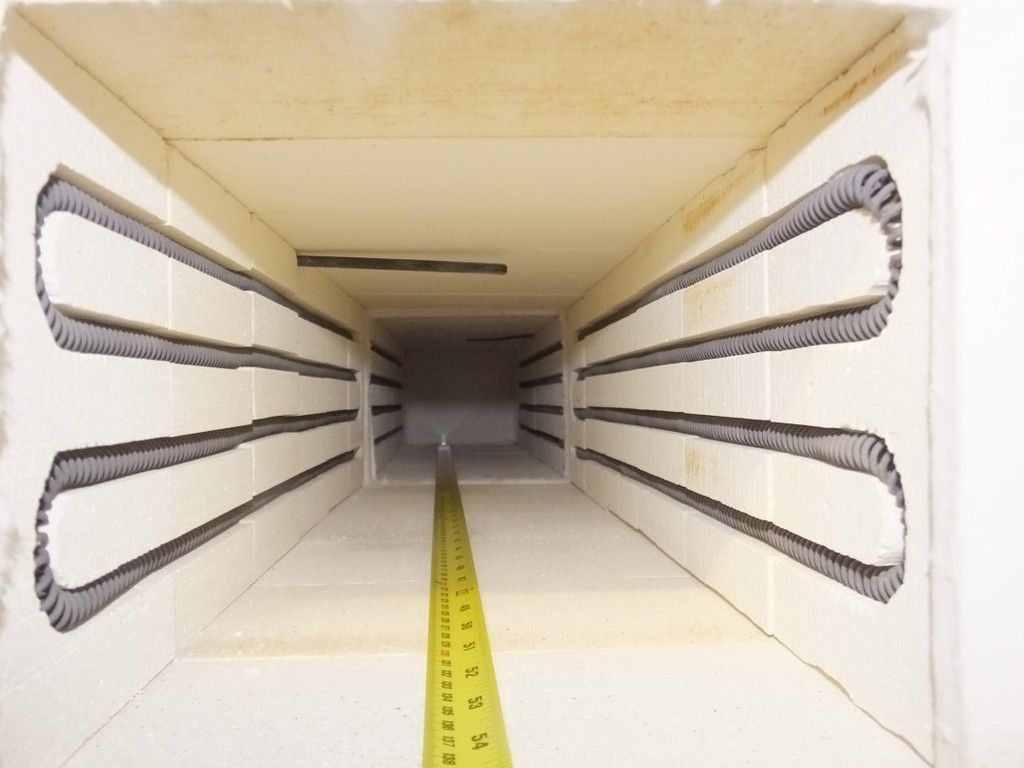

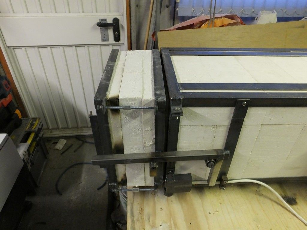

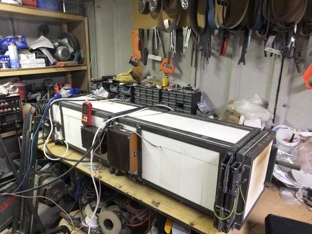

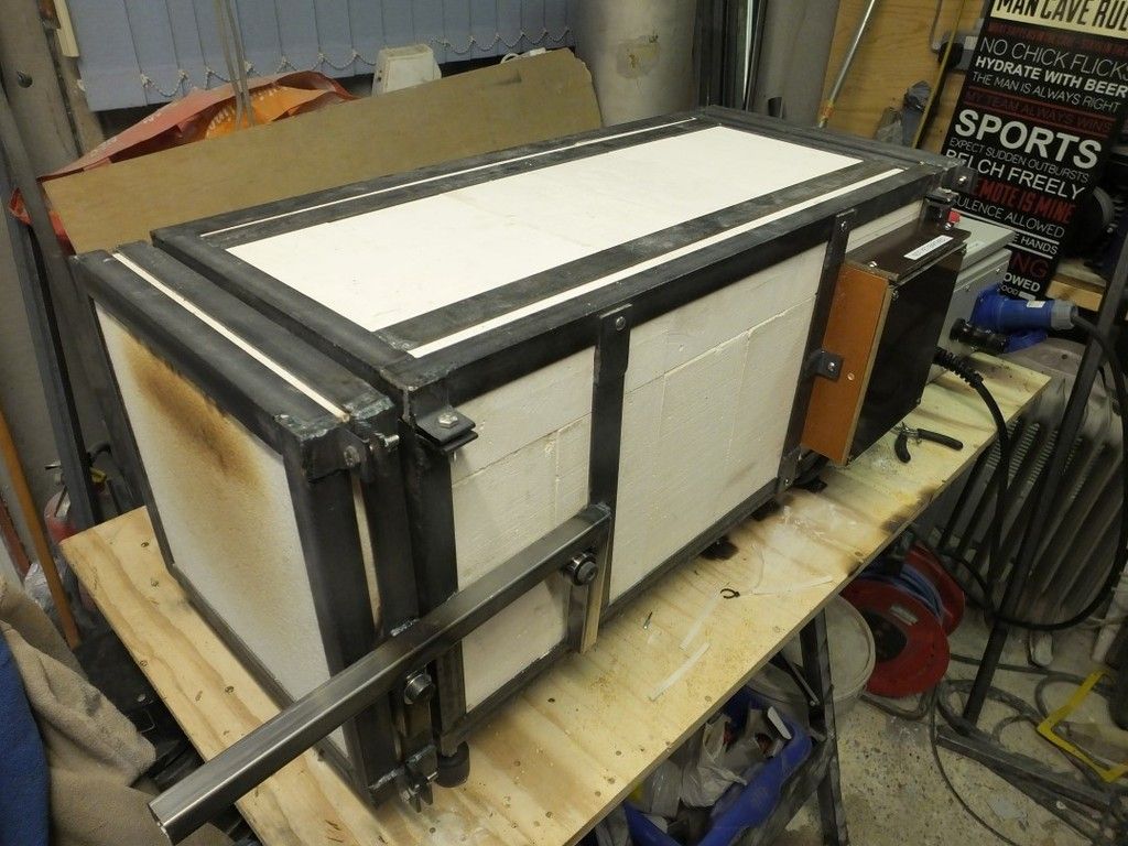

I've just finished building a couple of HT ovens that are each 28" long and will bolt together to make a single 56" oven. I'd tried pretty hard to build them identical so that they could both be run from a single controller when bolted together, but still found they needed to be run as separate zones using a controller per zone to get the sort of temperature control that I'd expect.

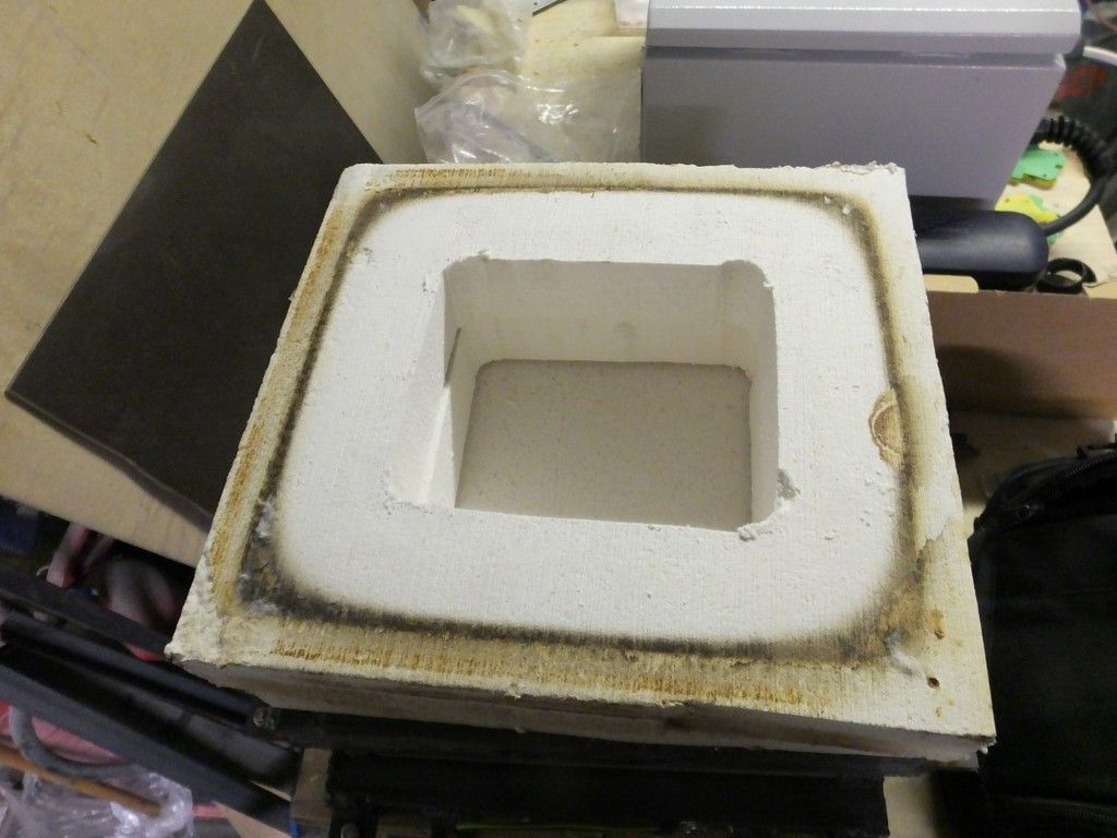

On the 3 kW elements, the 28" oven (6 IFBs long plus a 1", 25mm, fibre blanket door seal each end, which compresses down to about 1/2" with the door closed) will reach 1300 degC, 2372 degF, though it takes something close to 2 hours to do so. It will probably go a little higher, but 1300 degC was the limit of the type N thermocouple I was using.
From a cold start, 800 degC (1472 degF)was reached in 22 ½ minutes, 1100 degC (2012 degF) took 54 ½ minutes, the temperature at an hour was 1125 degC (2057 degF) and 1177 degC (2150 degF) took 71 minutes.
I suspect that aiming for 1100 degC (2012 degF) from cold in 20 minutes is being pretty ambitious. It might be possible with an 18", 450mm, oven on 3.3 kW, but I'd be inclined to regard two ovens at around 27", 685mm, each as more realistic.

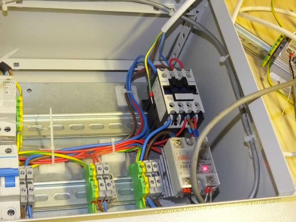

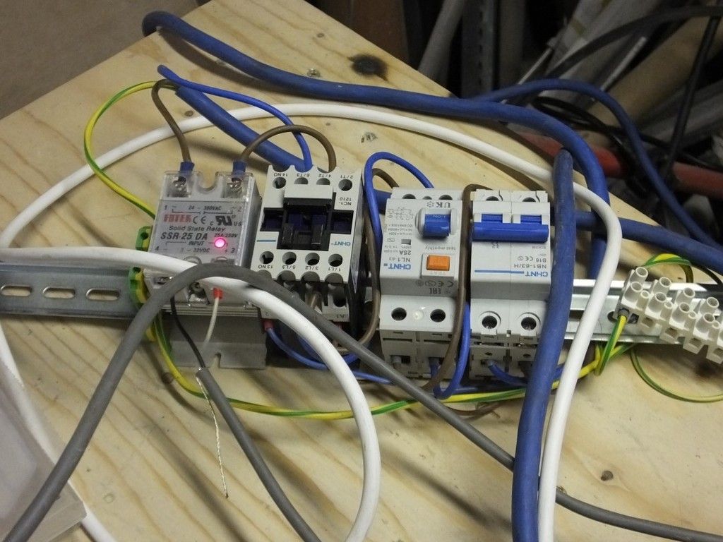

I'd do one controller with 3 SSRs operating 3 different zones.
I've done that with 2 controllers and 6 SSRs with good result on some vulcanizing equipment I made for a company.
It was all solidstate and easy to wire up. The Solid State Relays will kick on when the temp controller calls for heat.
Just use one thermocouple in the middle and it will turn all of them on.
I think you can control your heat treat pretty well that way in theory.
I have only done this on a belt cooker for big Goodyear rubber belts in coal mines and quarrys to repair broken sections.
The heater probes were inside big platens and the controller box controlled 6 heating elements with 2 controllers just fine out in the open atmosphere and cooked hot.
In an oven well insulated with one thermocouple in the center would work fine..

For most industrial applications, I'd expect the single control loop to provide adequate control. My dual-oven experience suggests that it is unlikely on a Heat-Treat oven even one that is horizontal.
The control thermocouple was the one in the front (master) oven and I lashed up a second SSR to power the slave oven off the master control output.
I attached a handheld readout to the thermocouple in the slave oven, set the temperature to 800 degC (1472 degF) and started it.
The indicated temperature of the slave oven seemed to rise faster than that of the master, showing a difference of around 60 degC at 300 degC and 240 degC respectively. The gap then closed until both readings were within a couple of degC when the master reached 800 degC. Leaving it soaking at 800 degC for another half hour, the gap opened up somewhat until, after half an hour of "soak", the slave was showing 795 degC with the master at the 800 degC setpoint.
I did not open the oven or do anything that might disturb the temperature distribution during this time: I was looking for "best case" values at this stage. 5 degC of difference is 9 degF.
Having gone to the trouble of building the ovens, I would want to see better control than this. Running off a single controller was an attempt at keeping the cost down and I don't feel the cost saving justifies the reduction in performance. In future, any joining of ovens will be done with each of them controlled independently by its own control box. This will give the tight control expected of an HT oven.
7" Wide, 6" High internally.
I think I used 27 bricks for each oven, plus the board for the door and the back. The bricks are 9" x 4 1/2" x 3" JM23 IFBs made by Morgan Thermal Ceramics. They are easier to find in the UK than K23s.
The door and back are a single layer of 2" Ceramic Fiber board.
I've discovered that knifemakers as a species are seldom satisfied: at least 2 of my earlier (admittedly only 18") ovens have been modified by the end-user to get longer work in. I therefore decided to make these 2 ovens easily (and reversibly) extendable by simply adding a couple of additional layers of the board to the door and back.
If that's not enough (36"), then it's a case of bolting them together.
