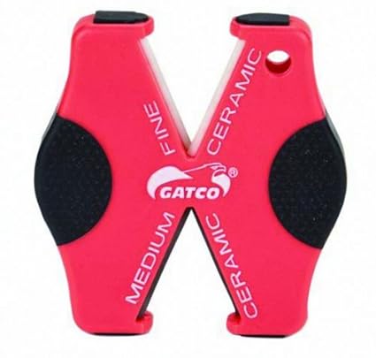

What is the best thing way to get a razor Sharpe edge on a 24 in. Blade katana forged out of 1075 carbon steel.
I just been using an older equivalent of the Gatco 6224 Super Micro X Sharpener
I do have diamond stones, but this works fairly well and is very easy to sharpen my 2 handed short sword:
IMG_20151214_13112-14-13-31-50_zpsevtryvtr.jpg~original
Put the blade (carefully, with pads) in a vise. Take a good stone to the blade instead of the blade to the stone. Take some leather, and glue it to a nice hard, flat piece of wood. Then, rub green chrome polishing compound all over it. Use that to strop the edge. In a crisis, with chipped or rolled edged, you can use an old (new-old-stock) Nicholson or Simmonds smooth cut file, and then go to coarse and fine stones, and then leather.
water stones if you want to be traditional. But, for the sort of cutting most of us do, rather than competition, a good edge geometry, and shaving-polished edge, can both easily be obtained this way. Doesn't take 10 minutes, either. You can also use a slack belt on a grinder, if you have variable speed and good grinder mojo.
I use the same file-stone-strop technique for axes and hatchets, too. You will be amazed how fast you can do this. You just need to kiss the edge with the stone. If the geometry needs changing, that's why God made smooth cut files.
