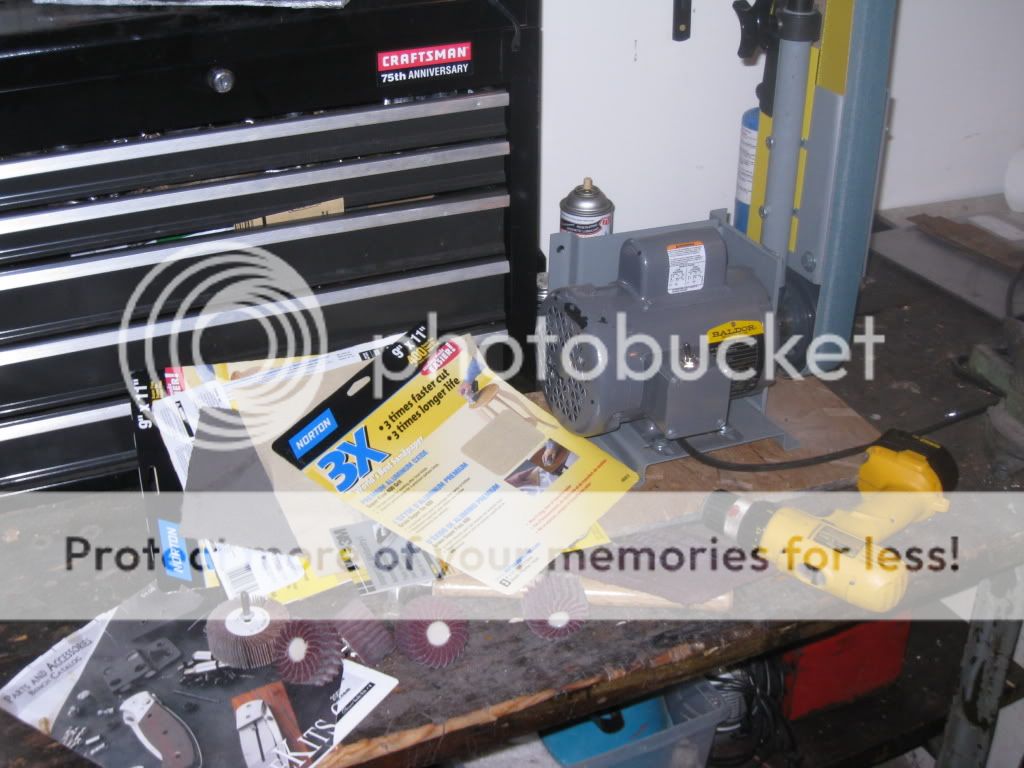

You can see the backing plate clearly in Jarvis's picture, its the gray block right behind the sanding belt.
