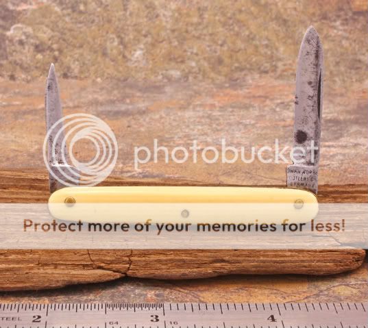

Take a look at this handle material. Bone? French Ivory?
Dec 31, 2000
17,079
From the photo this looks like French Ivory. Seller says it's bone.
Seems pretty obvious because of the bands. Am I mistaken?
No I don't think you are mistaken. It is definitely not Bone. At times you have to be careful because I have read that French Ivory did have actual finely ground Ivory added to the Celluloid - where as ordinary Celluloid of course did not have this.
Looking hard at the photos the scales are not Ivory either so you are bang on.

I have a small pen knife, marked Swan Works Cutlery, Germany with this type and look of scale.

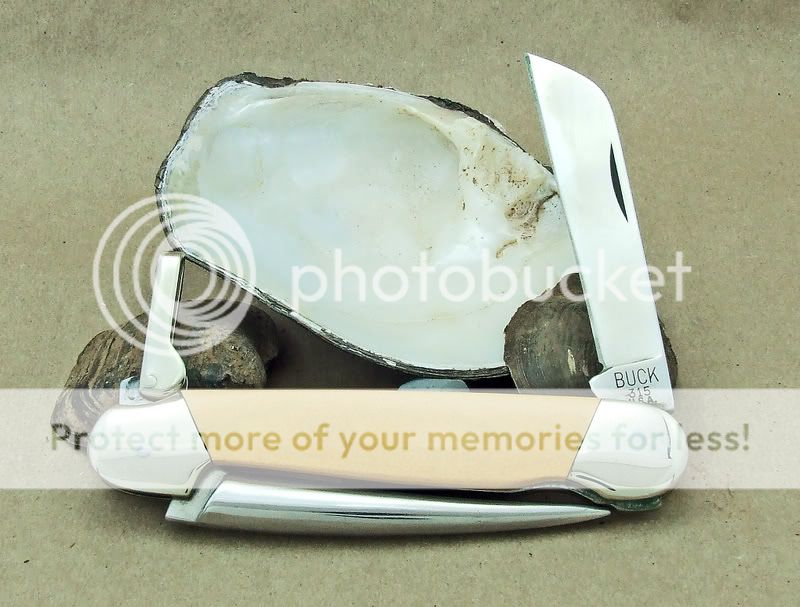

Don't know exactly how many French ivory Bruckmanns are in the collection; I'd have to climb into the vault to find out. But there's one in the bottom left of this pic:

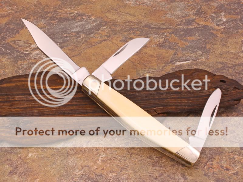

Other French ivory knives in the collection are some vintage Giesen and Forsthoff, one of them shown on the left in this scan:
I was photographing shields one day for an old forum topic and took this. Don't know for certain but this could be another Giesen:
