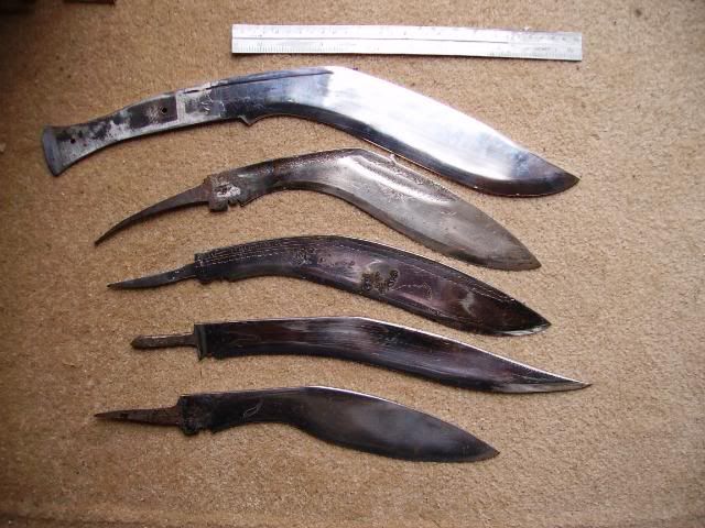

Could anybody make my day by posting a shot of a standard HI khukuri "stick" tang, naked, uncovered & totally bare, please?

Not HI's but should give a decent idea
This one from HI site
You can see few tangs on the pics below (Also from HI's site)
Didn't someone have an actual x-ray of a HI khuk? The kangaroo tail if I remember right
WWII model by Sher. If this had a handle it would be about 19" long.
View attachment 541462 View attachment 541463
Note the thickness of the tang in the second photo. In most HI models (including this one) the tang goes all the way through the handle and is peened over at the end with a metal keeper.

Rat tails on HI Kuks are very strong, has a better shock absorption and are much easier to redo if needed.
Yes, I recall some crazy man bribing his cat's vet to X-ray some HI khuks:)
Here's the thread with more pics: http://www.bladeforums.com/forums/showthread.php/871579-HI-Khuk-Handle-X-Ray
As you can see, there's plenty of steel under that horn or wood. Even the partial tang Hanuman has a beefy stub in there. And if done right, which it usually is, then it's soft and tough as well. I like chiruwa tangs, but have really come to appreciate what a "rat-tail" tang has to offer.

You're welcome amigo. It was easy for me to find. My vet thought I was crazy:) I thought it was a great way to see what lies underneath and it didn't fail to impress.
When you worry about rat tail tangs, remember that every european sword for two thousand years (with the exception of some seax and the Großmesser) have had rattail tangs. You can put a lot of leverage on a tang with a 38" blade...

I'm little surprised how short the tang is on a Bilton though.
