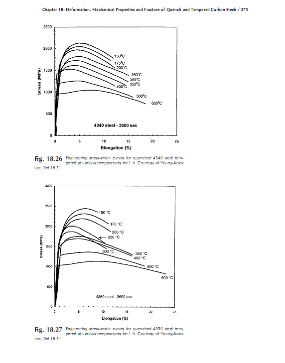

I think that a graph would be extremely useful.
Something like this... I know it is for martensite, but it is good example.
HOWEVER :D I bet we can produce superfine perlite with tensile properties BETTER than for tempered martensite.
The important part of your graph is the first sentence - "......fracture of quench and tempered carbon steels."

Karl - the graphs prove your point!
They show elastic "flex", then they show plastic failure, and the they show fracture - end of the line.
The elastic part of the graph is the same no matter how tempered, higher tempering temperature - the faster the (plastic) fail,
The only thing is they do include perlite, only differently tempered martinsite.

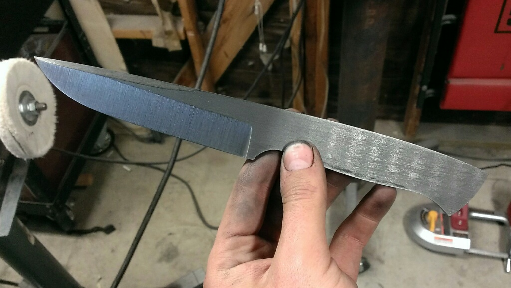

I'm roughing the below knife tonight for HT tomorrow. It will have some inherent taper due to the swedge and grind geometry, but it is an untapered stock removal knife when you get down to it. I just wanted to give an example that taper in the blade is a superb feature for a good knife, but not a required feature.
