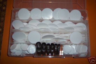

Teflon washers with knife punches on Ebay.
