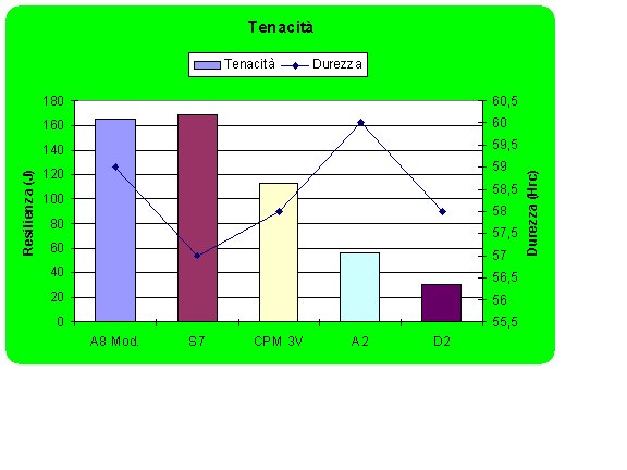

I have been looking at the Survive! SK4 made of S7 steel but am having a hard time deciding if it is work the money. How does S7 compare to 1095, A2 and 3V? Thanks

Quick question abou the sk4 and S7 steel, how does the steel compare to 1095, A2 and the 3V? I know its super tough but how about edge retention?
http://zknives.com/knives/steels/steelgraph.php?nm=1095,3V,A2,S7&ni=360,5217,11,571
CPM-3V has approximately the same carbide volume as A2 steel but is ~2X more wear resistant as well as ~2X tougher @ 60 Rc (all that vanadium and PM technology :cool:)
S7 has about 1/2 the carbide volume of those 2, is 50% tougher than CPM-3V @ 57-58Rc, but will be less resistant to abrasive than even A2, especially @57Rc. That said, you probably wouldn't be able to tell A2 from S7 at the same hardness if comparing both to 3V in terms of wear-resistance, both are just too low, not designed for abrasive wear. 1095, with virtually no alloying elements, will be even LESS wear-resistant unless taken to MUCH higher hardness (65 Rc) whereupon it is quite brittle. But most production 1095, e.g. ESEE knives from Rowen, leave 1095 much softer (55-57Rc http://www.eseeknives.com/esee-4.htm) which results in ~50-60 J of impact toughness, comparable to A2 steel at 60Rc but with FAR less wear-resistance.
In summary, S7 is tougher than all but only more wear-resistant than 1095. However, the SK-4 is higher hardness than, for example, the ESEE-4 and should exhibit not only higher toughness but also higher strength and wear-resistance.

S7 is as tough as it gets and with the right HT can be a solid blade steel for choppers and hard use tools.
The main issue with the steel is it only quenches to 58-59. It just isnt hard enough to support a thin (.010-.015) edge after tempering back to 56-57. If the edge is left fairly thick (>~.025) it can be a fine knife steel.
However for a smashing and chopping tool with some meat behind the edge it can be a great performer. Im looking into using it for some bush swords
To summarize, a very poor choice for a thin slicing knife and a solid choice for a hard use blade with a fairly thick edge.

S7 is a very tough steel indeed. Though toughness is not is all that's needed in a knife blade.
S7 is a very good candidate for a sharpened pry-bar, not so much for a dedicated slicing tool.
A2 is a much better steel when it comes to balancing toughness with wear resistance.

Keep in mind that discussing toughness is not simply a matter of breaking the entire knife, it can be reduced to breaking/chipping vs rolling at the very edge of your knife, i.e. dulling. Wear-resistance is against abrasive wear, most commonly experienced cutting material like cardboard, rope, hair-fibers (shaving & skinning), scraping (planer blades), etc. Slicing meat & veggies, carving/whittling wood, anytime there is risk of edge-impact - these depend more upon strength and toughness of the edge, i.e. highest hardness coupled with highest possible toughness in the thinnest possible geometry to stabilize it.
1095CV at ~56Rc (e.g. Becker/Kabar BK-16) has the lowest strength, toughness, and wear-resistance of the group. Unless it features substantially thinner geometry, it is inferior on all counts, and the coating is thicker and prone to dragging. Also, the product design (handle shape, materials, sheath, etc.) may be inferior, though the handle is longer, more accommodating of medium-large hands than the SK-4. And the BK-16 can be had for <$70.
BRKT Bravo 1 in A2 steel @ 58-59Rc is stronger and tougher and should have thinner edge geometry for improved cutting efficiency (though this may equalize them in strength/toughness, which is indeed the point). However the standard Bravo1 design is pretty sad. To begin, it is too fat but the "LT" version is better, you need to be sure to order one that is rampless, preferably drop-point, their thumb-jimping is NOT user friendly, they've had sheath issues so be selective there, their vast offering of pretty scales are mostly too slick, and the handle is so straight and round (at least on the fat version) that the knife tends to twist in hand. The destruction-test on a Bravo 1 did not go well (edge too fragile), but as previously stated it is quite thin at the edge (or mine was, anyway) and it sounds like you won't use it too hard. Oh, and then there is the reputation of their fans and the owner (Mike Stewart) ... yeah, I won't go there. And you can get all that for $200+ especially if you upgrade to 3V.
Survive! SK-4 is S7 steel @ 57-58Rc, much tougher than the rest but not quite as strong, not quite as wear-resistant as A2, it has 2X thicker edge geometry than the Bravo1 (0.028" vs 0.015") so it won't cut as aggressively unless modified... but it has superior handle design, the blade is cerakote'd to prevent corrosion, it comes with an excellent sheath, and as B34NS indicated, it is easy to sharpen. Can be had for <$160.
Survive! GSO-4.1 is somewhat superior to the SK-4 in almost every way but is also more expensive ~$190 unless a "factory second".
