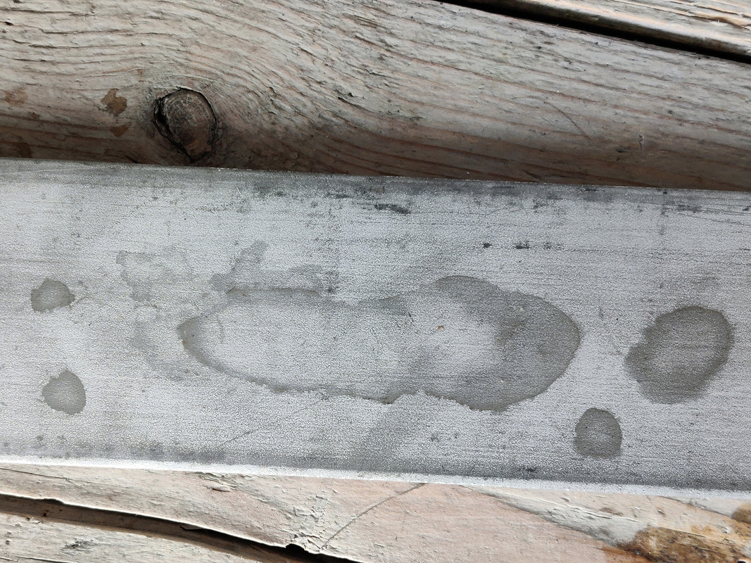

My first post, so cheers to everyone :). I got a bar of eighter D2 or A2 steel - I just don't know. Is there a way to tell which one it is? It's not magnetic. I would appreciate some help. Though I am not sure if one can tell the difference at all. It might be impossible to answer... Let's see! :)
thanks!
I am positive it's eighter A2 or D2.
I just used a stronger magnet and I can confirm that it's magnetic. I also dropped water on it. Some drops already dried up, but no corrosion. Just some dark rings/patina kind of thing
This is what it looks like after vinegar and water... I lack the experience to be able to tell the difference between D2 an A2. I am leaning strongly towards D2 though. What do you guy's think?

I think you might be analysing the mill scale not the steel, grind the scale off and then do the test.

It does not matter how strong magnet you use .If metal is no magnetic even strongest magnet on earth will not work .
If you do your own heat treating, harden a small coupon for A2 on the lower end like 1725’f, and check the hardness. The D2 should under harden at that temperature.
Hoss
N Natlek : It's barely magnetic. Only a stronger magnet made me notice any magnetic force.
I thought D2, although fairly stainless, takes a patina relatively quickly compared to other stainless steels. Especially with acid. D2 should be very tough to work, even when annealed - notably harder then A2. I am afraid that's hard to judge though!
D DevinT : Unfortunately I don't do my own heat treating :(
I guess there's no way to tell which of the two steels it is...
I agree with Larrin. It isn't worth the worry since they are vastly different in HT.
As an alternative, cut off a 2" long piece and send it to a friend who has a HT oven. Have him do what Devin suggested and test the hardness. It would be even better if tested against a known sample of A2 and D2.
