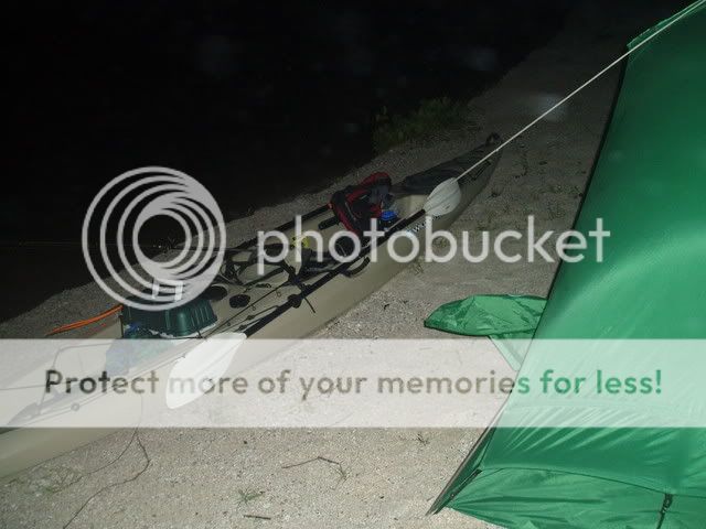

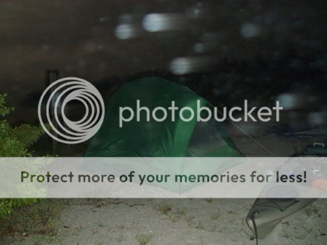

We had four tents, and my Eureka Timberline 4 was the only one still standing in the morning. My tent poles were a bit bent, and I was the only one who had tied my tent to my kayak on one end and a large post on the other. The sand did not hold any of the tent pegs well at all. Can anyone recommend tent pegs for sandy contidions?

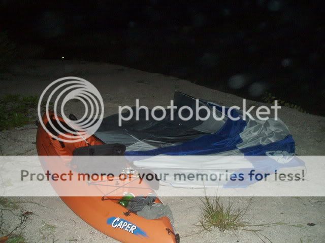

The other three tents were even cheaper k-mart tents.

Here are a fewe pics from my Tropical storm Barry Trip:
