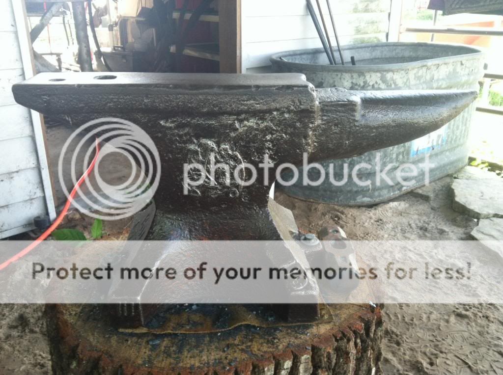

I was permanently loaned an older anvil w/out any makers marks that weighs Appx 240 Lbs. It has excellent rebound but the top is a bit dished? Maybe less than 1/8 inch? I would have to measure it. Is this OK for forging? I only do stock removal right now but plan on doing forging this winter. Seems like it will be hard to get a nice flat blade if it's dished out a bit? Thanks for the thread! DonO
Great thread idea SinePari!
Even an anvil with a dished face, swayed back, broken-back etc will serve you well when it comes to forging. This form of damage is exclusive to wrought iron anvils and built up wrought anvils with a tool steel plate forge welded to the face... Wrought Iron, or at least high-quality wrought is nearly void of carbon, fibrous, and very malleable in comparison to tool steel. It's pretty neat stuff to look at on an anvil and sometimes, when well finished, presents itself like wood grain. When an anvil is heavily worked all that energy directed in one area starts to sway or dish due to the malleable wrought underneath.
Another feature that comes with an anvil that doesn't have a perfectly flat forging surface is straightening a forged blade or having the means of ever-so-slightly correcting warped blades post quench... It's a PITA straightening hot steel on a dead flat surface...
Post pics of that beast, might be able to give you more info on it...
