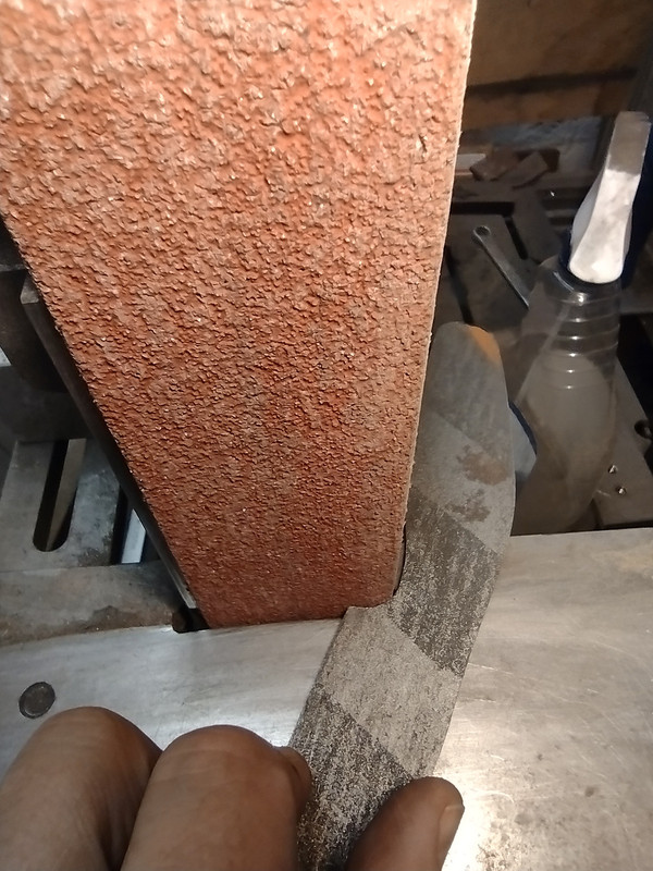

The way I do my smaller radius is to walk/track the belt off the platen.
Then I press my blank into it flexing the belt into a nice, kinda tighter radius. This is about 5/16" R
I don't use small diameter spindles.
I'm a former tool room machinest I Could make themr if I wanted, but This way works So Good .
I think I first saw it from Nick Wheeler?
Posting for New people who might not know about this technique
*Edit
If you zoom in, on the left side of the picture you can see my platen exposed. I have the belt maybe 3/8" over to the right, walked off.
-if I left the belt centered on the platen, I wouldn't get the nice radius.
that's how I do it, I do all my profiling with the knife horizontal and use the edge of the belt a lot. Profiling is one of the few things I do that I rely on a work rest for
