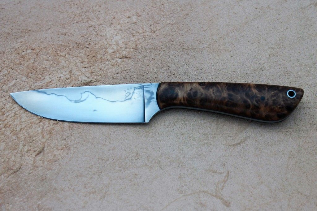

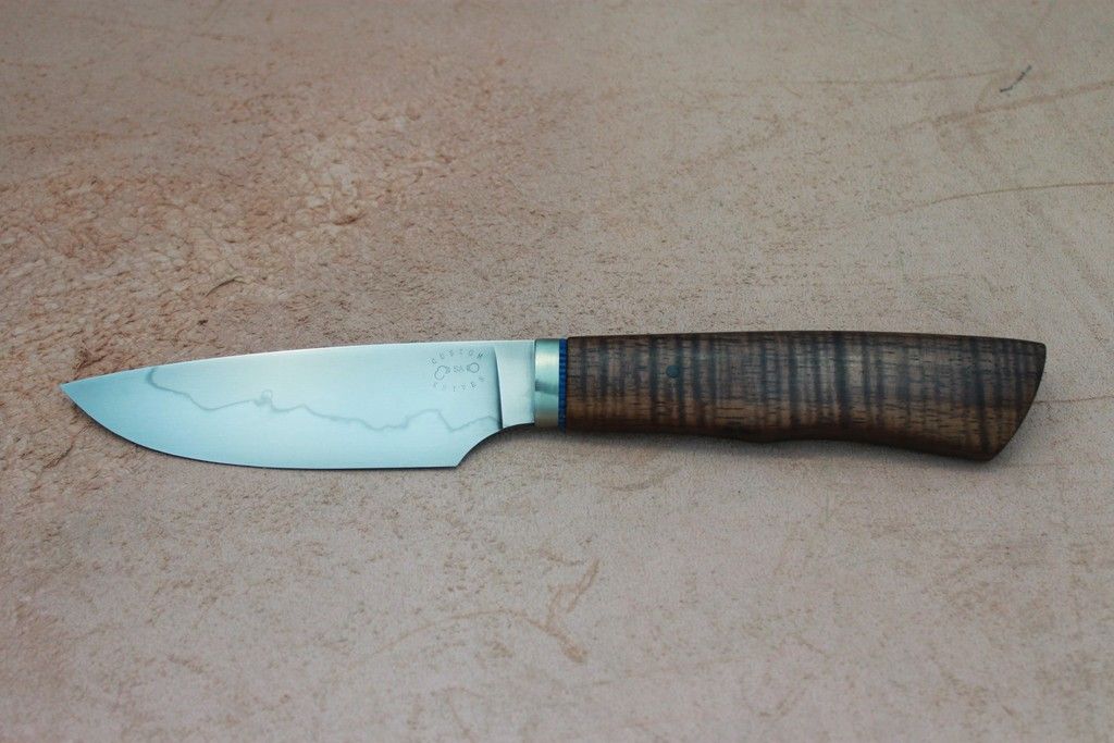

first I sand mine up to 2500 grit and rub the blade. after that I etch in lemon juice (many many times) util I have achieved the desired effect. In between etches I take the oxides off with glitz and i scrub the blade with various grades of pumice. the pumice really brings out all of the details in the hamon.

Thanks a lot! I use 00 and 0000 pumice that I ordered in bulk from eBay. Mix it with a little oil to help lubricate it and rub it in vigorously. I start with the 00 and as my etching progresses I move on to the finer 0000 when I am closer to finishing.
