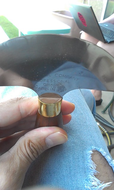

Is the brass ferrule important on my knife? I'm just wondering what they are installed for other than looks. I can't see why it's needed, but I may be missing something. My knife has a hidden tang and I'm wondering if there's any reason why I can't grind off the old handle and fashion a new one from g10. The knife is good but the wood isn't my favorite.
I would say the ferrule is important for two reasons
1) Looks
2) the blade is hardened. The shoulders could wear on the softer materials, creating a fit problem over time.
1) Looks
That makes sense. One thing I forgot to mention is that the ferrule is filled, at least at the top, with epoxy (epoxy, according to the manual). Other than that I'm not certain about how it's mounted as there are no pins or lanyard tube
You think there'd still be a possible issue using g10 without the ferrule?
I am going to use a piece of g10 for my ferrule. It should hold up well enough. Odds are it is just epoxies into the hole of the handle. Which is fine,
I think ferrule construction is done because its easy and simple and prevents the wood from splitting. Kind of industrial slap er together often. Strig buddy your jeans are tore up.
Oh yeah, I did see that you were using g10 for the bolster. Duh. Thanks man, I hope you didn't mind me getting off topic. I'm really looking forward to seeing this progress. I'd love to hear how the grinding goes. I'm not ready to grind a head knife yet, but I'll definitely be sub'ing the thread for future reference.
Dude are you looking at my leg? I'm telling Nichole! :p
