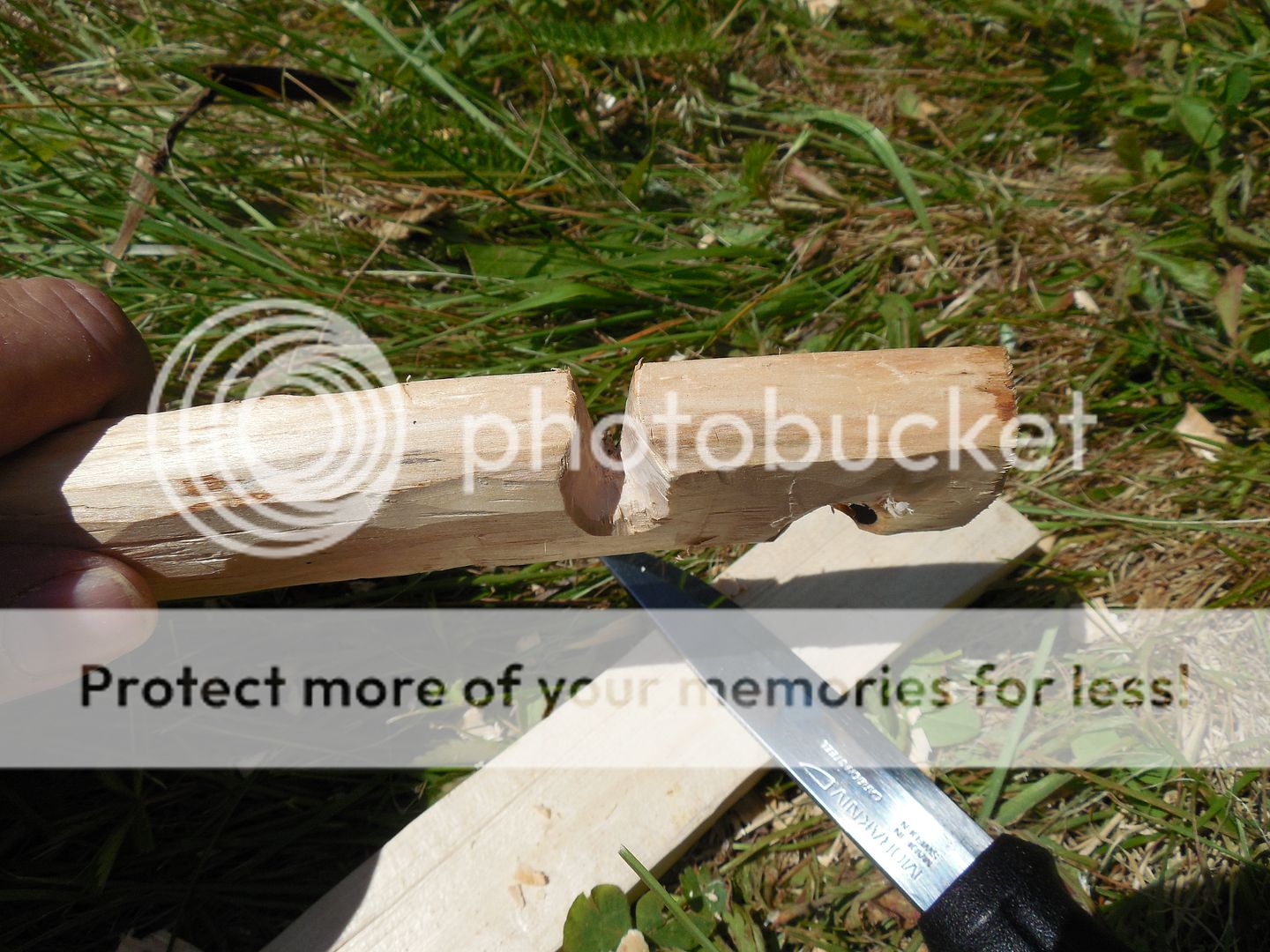

Burn-in an V-cut to collect the dust. The knife had a bit harder time doing the V-cut than some of my other heavier blades. But only by a small margin.

Widened up the V-groove then opened the bottom more for greater airflow.
Rested the fireboard on some the left over wood shavings plus used a wood chip to collect the coal. Hoped this would keep everything from sinking in. No expert at any of this so my speculation and actions could be wrong and only coincidentally successful. Wouldn't be the first time that happened to me.
