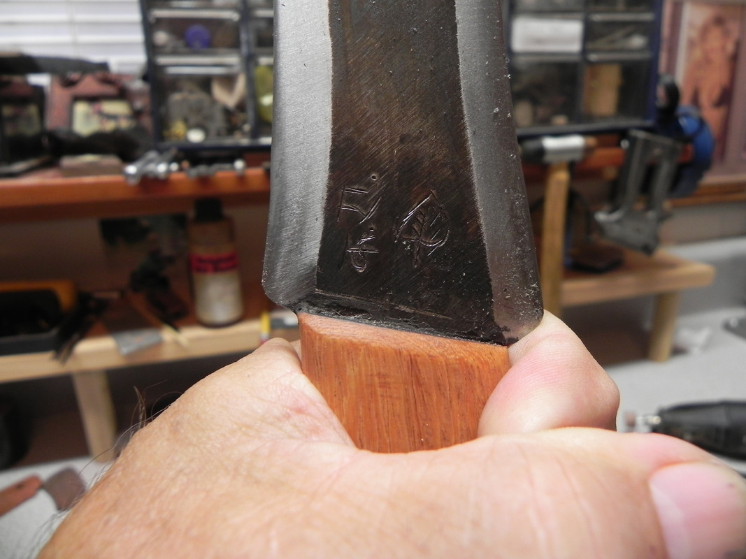

Some photo's although I didn't have Red Flower here to help so had to go solo.

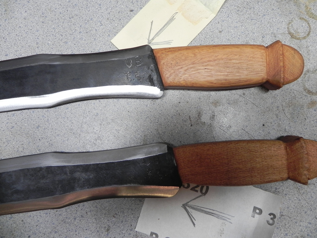

As you can see by my crude arrows, these areas top and bottom were sharp all the way to the handle and even on the vertical plane going down to the handle. Gripping the handle especially with a larger hand and squeezing just invited getting cut. The top knife is as they arrived, the bottom one I rounded off the top and reshaped the bottom and created a little notch for the pointy finger.
Very minimal but truly effective. I flattened those areas and knocked off the sharp edge for an inch or so on the blade, a little safety margin.
Then checkering the handles greatly improved the grip in itself, so I think kumar would be pleased, Bharaiv would not be offended and hopefully nobody gets cut.
After modification.
Before modification.
With this type of wood, the checkering is hardly noticeable to look at but quite obvious when you pick it up.
Anyhow thanks to Howard for the idea's, guess the little notch on the bottom was something he employed on a kitchen knife for much the same reasons we have here.

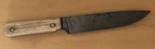

Here is the kitchen knife Bawanna mentioned.
The semicircle at the blade/handle juncture was ground out with a dremmel tool. This is a subtractive approach to the slippage issue. This knife with the modification has seen kitchen food prep and utility use for many years.
Depth of the depression can be varied per the end user’s taste.
I could probably increase the size of the depression some. It's still very attractive yet gives just that much more protection against forward slippage.
