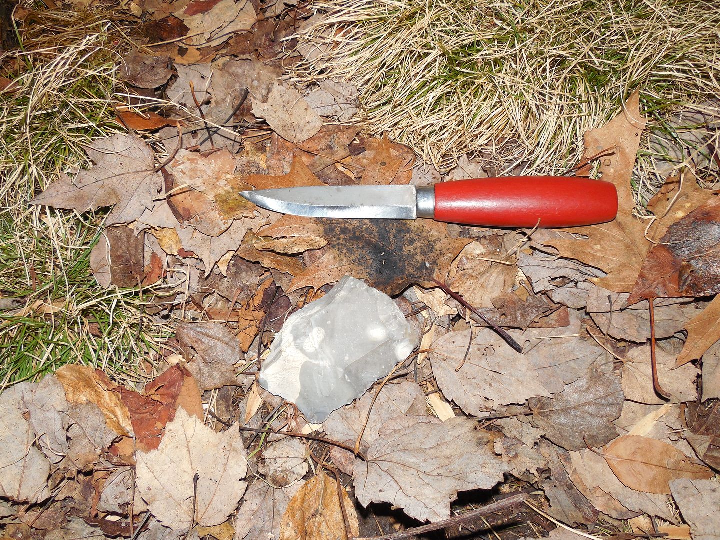

The methodology employed in the movie is traditional flint and steel which differs from the more modern ferro rod. I would need a rock in order to toss sparks from the carbon steel knife. Some rocks work and other don't. In general if the rock is hard and can take an edge it could produce sparks from carbon steel. Flint, chert and quartz comes to mind. For me often quartz is the easiest to find as it really stands out. I prefer to look in areas of drainage as often the dirt and leaves are washed away exposing the rocks.

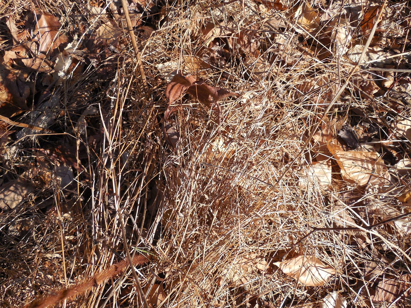

Ordinary these beech leaves would attract my interest however the rules of The Revenant firecraft are that dry grass is to be used. Dry grass isn't my prefered tinder.

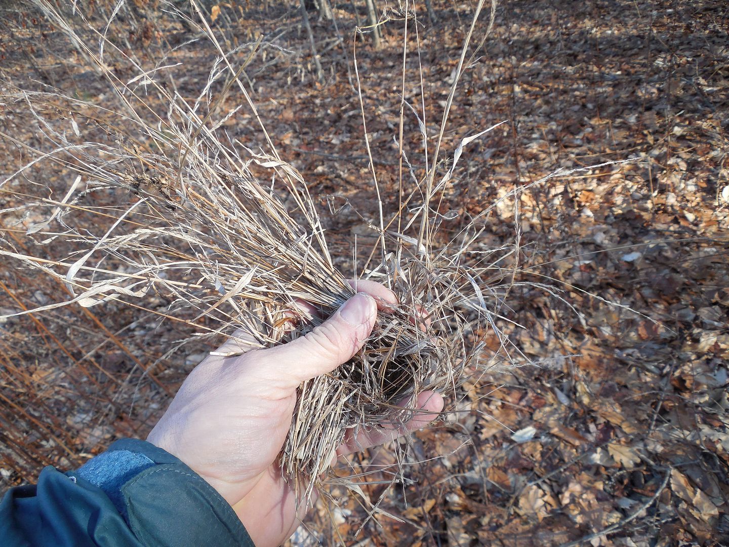

There is it! The dry grass of Hollywood fame! Not all dry grass is exactly dry. I avoid the parts of the grass in contact with the ground or other plants such as the lower stems and roots. Naturally given the numerous strands it's hard to be perfect at it.

I would need to process that quartz using stone age technology and sloppily at that.
Some nice flakes with sharp edges. Quartz doesn't seem to hold an edge as long compared to flint or chert but for a short time it will toss some nice sparks from carbon steel.
