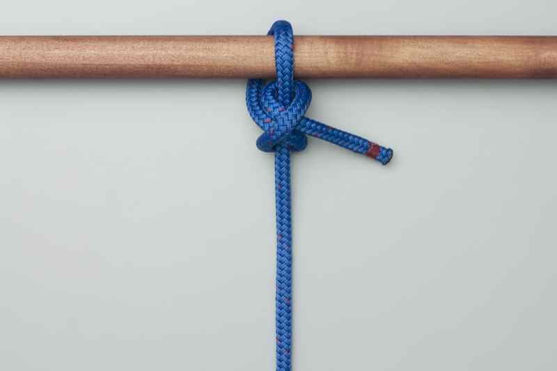

Probably my favourite and most used hitch is the Buntline Hitch. It's fast to tie, even one -handed, it's very secure, and very easy to untie if made slippery. You will notice it is basically a turn with a clove hitch around the standing part. When tightened, the knot will pull up against the anchor point.
(Please note: no knots are recommended as climbing knots, unless labeled as such - climbing is beyond my realm of experience).

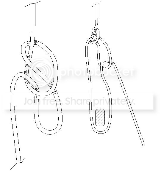

And just to spice up the thread a bit, an experimental hitch made with my aformentioned affection for toggled knots. The toggled hitch does not pull up tight against the anchor point.
One of the purposes of a toggled knot is ease of untying - remove the toggle, the knot disappears. However, depending on the application, the toggle could fall out on its own, thereby untying the knot. You have to match the knot to the application.

I also like the Trucker's Hitch and use it for the same things you mentioned above.
Here's another way to make it easier to untie:
Basically, 1/2 a Sheepshank, toggled.
Normally, what I do though, is use a Single Lineman's Loop (AKA Alpine Butterfly, IIRC) in place of the slip knot - I find it much easier to untie.

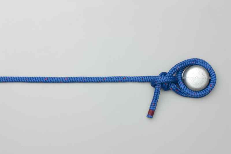

with my family-of-knots thinking, I thought I would point this out:
a buntline hitch is just a rope passed around something, then the working end is tied to the standing end with a clove hitch
and a clove hitch is two alternating half hitches
so
half hitch, clove hitch, buntline hitch and constrictor knot are all related
half hitch
(pic from wikipedia)
clove hitch
(pic from www.animatedknots.com)
buntline hitch
constrictor knot
