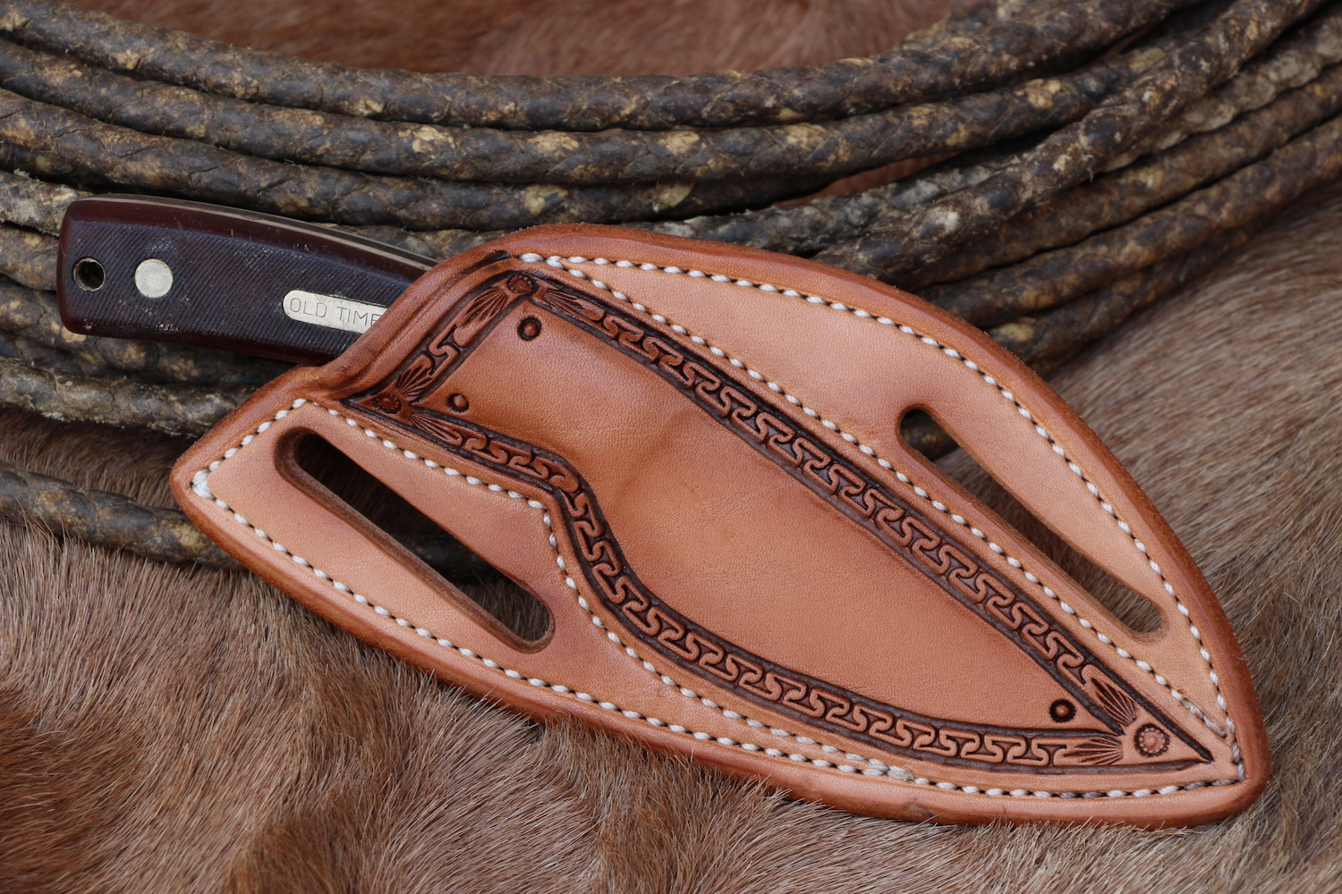

A folded Slot and Loop Sheath. Larger knife this is 8/10 oz leather:
Folded Horizontal Sheath 7/8 oz leather:
Three piece construction 7/8 oz leather:
You’re a true craftsman, sir. This pattern is wonderful- I imagine you just slide it on your belt with the knife outside the belt?
Thank you. Yes here's a pic of the back:
