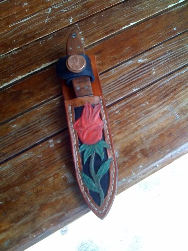

I used something similar on this sheath, dyed black and sandwiched in the layers.
Walter
