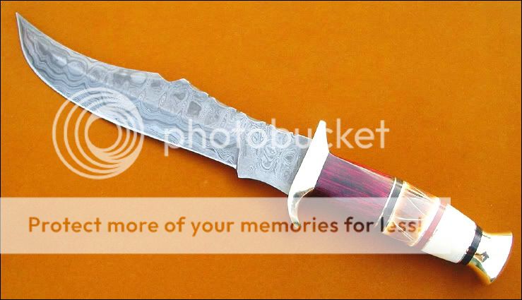

Logic, otherwise known as good old common sense, would dictate that thirty-five bucks just ain't gonna buy a quality Damascus knife. Yet they're selling like hotcakes on eBay and even at Amazon for a bit higher. I've bought a few of these Pakistan-made beauties just for their looks. And people I've showed them to have reacted positively. (My brother actually asked me for one, and he never asks me for anything...so I gave him one and he fiddled with it for the rest of his visit. Then my sister, who does ask me for things, saw my brother's knife and she asked for one, leaving me with one, which I gave to my mom since I know she wanted it but would never think of depriving me of it. She also coveted a Jennings J-22 .22LR pistol I had and she had asked me for it. So I gave her both (she's in Stage 2 of Alzheimer's, so she said, "Don't worry, you'll be getting them back.") And no, we didn't give her any ammo.)
So there's no doubt the things are pretty. I have a much better grade of Damascus knife made by Bear, but although attractive, it's clearly not as attractive as these folded steel manhole covers/steel drum specials on eBay. One seller even advertises his imports' FEATURES & SPECIFICATIONS:
~ Blade Material: Damascus Steel 15N20 & 1095 Hand-Forged
~ Blade Hardness: 58-60 HRC on Rockwell scale
~ Total Layers: 512 (8 folds German 1095HC/Swedish 15N20)
~ Handle Material: Maple Wood
~ Sheath: Genuine Cowhide Leather
The sheaths are mass produced and the tops cut off at the top to fit the various "custom" knives that are also mass produced. I was just trying to get a bead on the German 1095HC and 15N20 Swedish steels.
So who else buys these knives and has anybody actually subjected them to rough use? Many of them are full tang, so I'd like to find out if they hold up or just break when subjected to stress.
Thanks for any replies and feedback. Will try to run a few photos soon. Meanwhile, if you have any photos, please post!

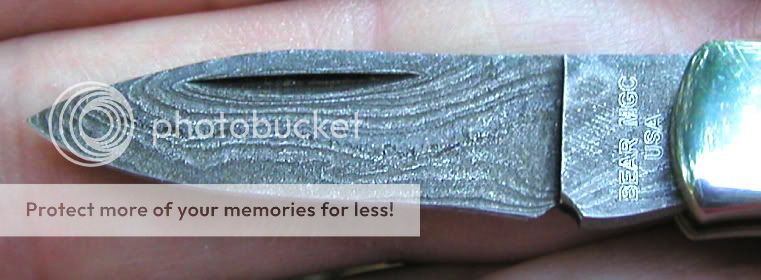

The cheap Damascus knives look good, and to be fair the tangs on many of them are far more more robust than the knife in the video. The one in the photo below have hidden tangs, but I have two with full tangs. My Bear & Sons knife is very durable and keeps a great edge, but the blade is not as beautifully etched.
This is the blade of a tiny Bear folder. Very nice.

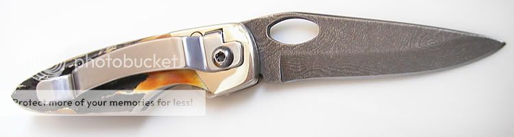

And of a larger Bear folder:
