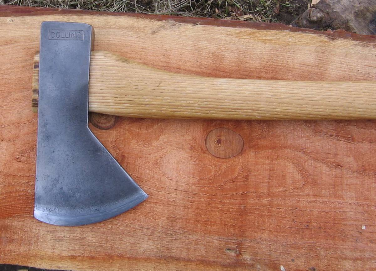

Finally! After a few years of looking for old axes at garage sales and flea markets, I finally found a Hudson Bay pattern that wasn't priced like some ebay seller who thinks he has a gold brick. I bought it without even giving it a close look. It has zero rust and a beautiful patina--better than any other axe head I've found so far.
From the top:
From the bottom:
But now onto the issues. First, someone clearly pounded on the poll. Damn thing looks like a lead-nosed bullet entering a block of gelatin. But the eye doesn't appear to be deformed so I don't think it's an issue. Normally I'd grind off the mushroomed edges so they didn't stick out so much but I don't want to ruin the patina on this one. Not a big deal, really.
The next issue is what I'm a little confused about, maybe even disappointed in. From a birds eye view, the profile honestly doesn't appear as well-refined as I had expected for an old axe that usually gets so much attention and admiration. I wasn't alive back then so I don't really know but I've read enough on the internet to get the impression that back when axes were made the "right way" they had thin bits and concave cheeks that gently tapered to the eye. This is what I've seen on every video/blog post/thread that discusses what a "proper" axe head profile should be. It's also what I've observed on any of the high end modern axes like Gransfors, Wetterlings, etc...But it is entirely possible that this whole thin profile idea is just a bunch of internet bullshit and an axe doesn't really need to be ground that way. It's a crazy idea, I know, but the internet could be wrong. And that's what I am here to find out. Thoughts on the profile of this thing? Has anyone else seen a lot of Hudson Bay patterns? Did they look like this? Better? Worse?

Thin cheeks like those are great for limbing and light bushcraft work which is what they're designed for. The thin cheeks don't do as well at bucking or splitting which your axe is really too light for anyway. So recognize it for what it is and use it and enjoy it for what it's intended for.
And I would absolutely file the poll flat. There's nothing sacred about these things. Just tune them up to do their job.

Thin cheeks? Hell, I was comparing it to my Gransfors hatchet and an old Hults Bruks I have, and I was thinking this one seemed a bit chunky and unrefined. If it were yours and you didn't care about the patina, would you grind the cheeks down and make it thinner, or make any other changes to the profile?
As for the poll...I'm on the fence and leaning against it. I've never found an old head with a patina like this so I don't want to sand that off but from the standpoint of pure functionality I realize it would be a good idea. Honestly I don't know if this thing will end up getting much heavy use. I already have a good hatchet and a 2-1/4 lb Hults Bruks on a 22" handle so those two are really everything I need for any backpacking/canoeing/hunting that I do. This one was not a purchase based on any need--it's a collector's item. I can always grind it down later if I decide I want to make it a workhorse.

I'd take a hammer and carefully pound back down as much of that poll material that you can, then use an angle grinder or file and take down the rest.
You should be able to avoid ruining any of the patina on the rest of the head.

Any risk in hammering on the poll? How do I ensure that I don't deform the eye or anything? Do you hit it directly with the hammer or use the hammer to pound on a block of wood or something?

All you need to do is hammer on the mushroomed out material on the top bottom and sides of the poll.
Since you'll only be contacting the mushroomed out material there's no risk of deforming the eye, just make sure you wear eye pro in case anything comes off and don't use anything too heavy.

The earlier Collins Hudson Bay was made by approximately 1900 and was marked Collins Legitimus. They were always marketed towards campers, trappers, and the like. They were not logging axes. They were designed for small wood so were a flatter profile. Later Collins changed the axe stamp to the block style like yours. This was about WWII but I'm unsure of the exact year. So I would guess WWII to 1966 would be the age. The poll was designed for hammering tent stakes, trap anchors, etc. but some people get carried away with the hammering. The poll is not hardened.
