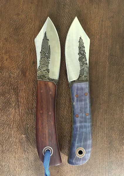

My latest 'falcen (maple, I believe?) flashes all over the place in the light. Thanks!
(The knife is blue, blue, blue in person but has a maddening propensity to keen purple when seen through a camera lens.)
~ P.
