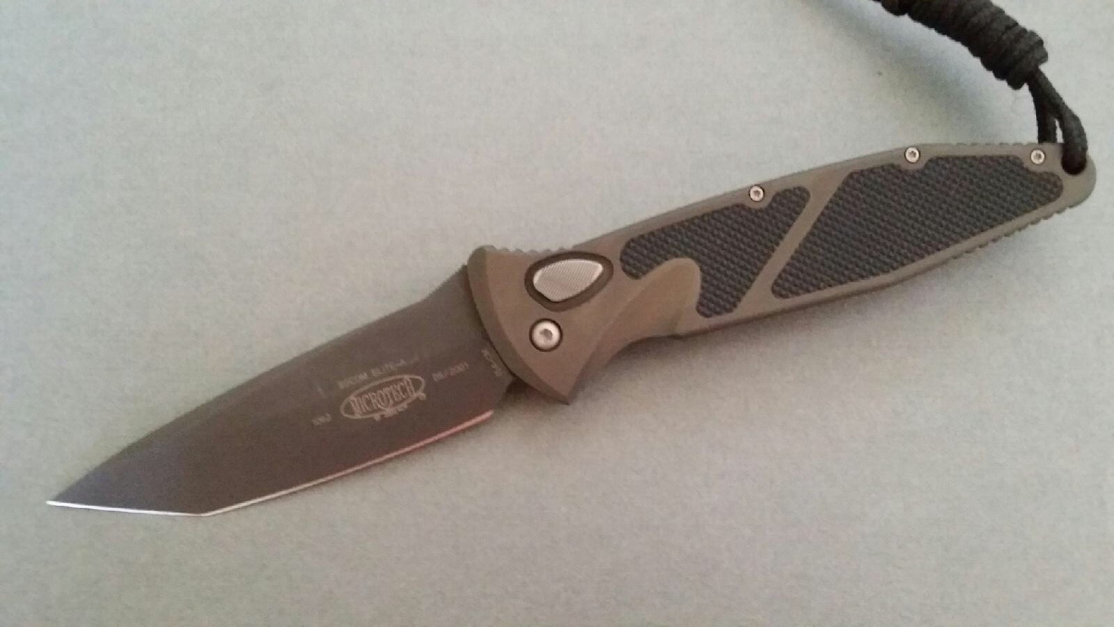

I bought a Microtech Socom Elite auto with a coated blade off the Exchange. There were quite a few 'scratches' in the coating. I sprayed Ballistol on it, let it sit for a couple hours and then worked it in with an old toothbrush.
The knife was built in 2001. Can't see those 'scratches' any more!!

^ You did an excellent job on that blade, Joe! :thumbup:
Sup big John!!! May I thank you again for parting with this beauty bro!!! I'm loving it!!
Joe
